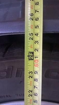

It doesn’t appear much lower than mine (26” at the top of the wheel arch), but I have long tube headers with V-band clamps at the collectors which I use as skid plates. I avoid speed bumps and dips like the plague, but track transitions still scrap. I can’t speak for suspension because mine is full custom and would not be relevant to your situation. I have friends that have had great success using weight jacks. Something to consider.

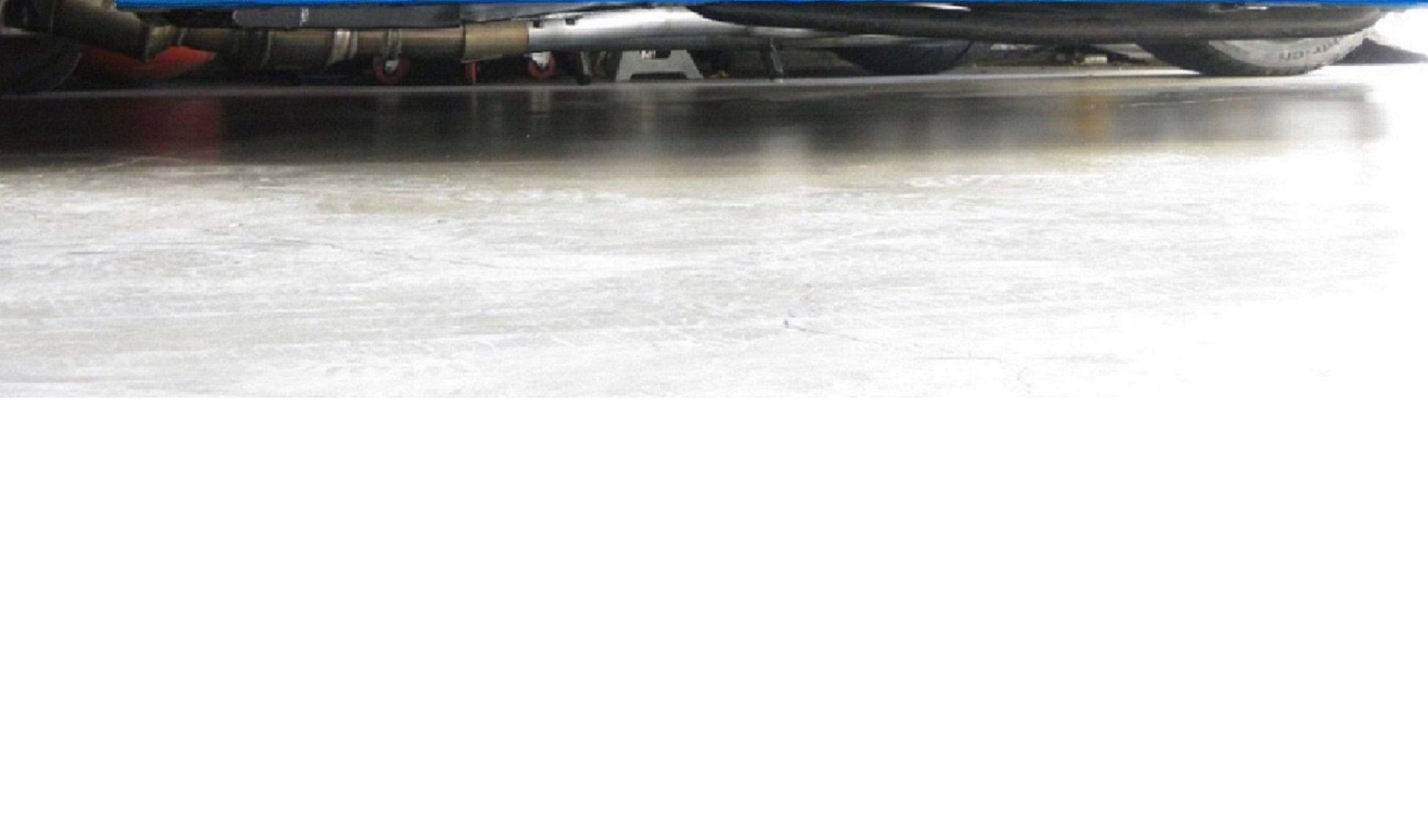

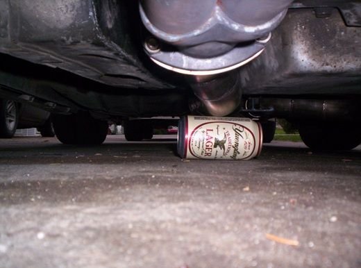

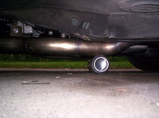

Car doesnt look that low, as mentioned. Perhaps the exhaust wasnt tucked up close to the floorboards, like 1/4 from touching, close.
I have Ground Control weight jacks. Car is lowered some 1.5". exhaust/subframe connectors/x-member dont rub on speedbumps so long as i go slow over them.

My car is very low with rear Sportline springs and UMI front weight jacks. My exhaust hugs the bottom floor pan which I feel is the biggest issue with these cars. A custom crossmember or use of the Holley Blackheart system gives you room around that portion of the floor for exhaust routing.

Pics help too, but why only ls3 cars? Its probably more to do with the exhaust hanging too low, maybe. Thats usually the likely culprit.

Mind taking some pics? A parking lot side shot and chin to ground clearance isn't very helpful
Underneath would be preferable. Without seeing what's hanging low for your car, we can't do much more than speculate
Low hanging exhaust is the usual suspect. Scraped up tubing will point out the problem areas. If it's banging on the rearend or suspension, then it'll also show marks. Since a local exhaust shop made the system, it's impossible for us to assess the system that you haven't shown any pictures of
Aftermarket torque arms can (but not always) also make a ruckus. They often strike the LR floor pan and slowly "self clearance"
Thumbing through your build thread, you have both. Neither problem is limited to LS3/T56 spcifically
Also, lose the chip on your shoulder. We're all enthusiasts trying to help you. Reading this thread, I didn't see any snarky comments before yours. Even if there were, you as an adult should be able to take the useful information from them. Lord help if you get a reply from sofa

Agreed. Pictures are needed.
It's not about what you have but rather what it weighs.
With an engine certainly heavier than the OPs (Gen 1 iron headed SBC at about 550 compared to the all aluminum LS3 at an estimated 500) and a transmission that's heavier also (700R4) all in a chassis that's been lowered 1.5-2", my very tucked up y-pipe still scrapes.
Where is it scraping? Pictures tell the story.
Front fender.
I've managed to speed bump flatten that spot where the beverage can is sitting.
