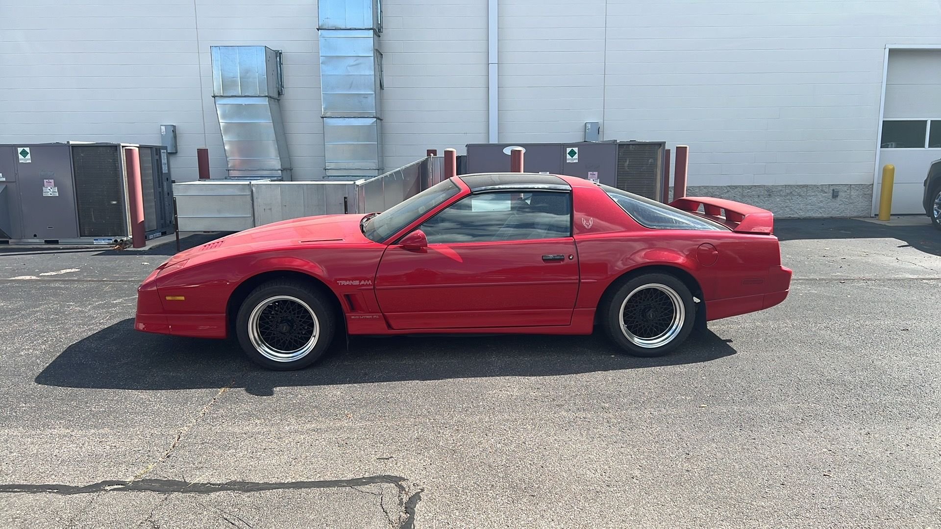

Here is my car prior to doing any of the brake or suspension work and it already say too high in the front. And yes, I did make sure it was clocked correctly.
