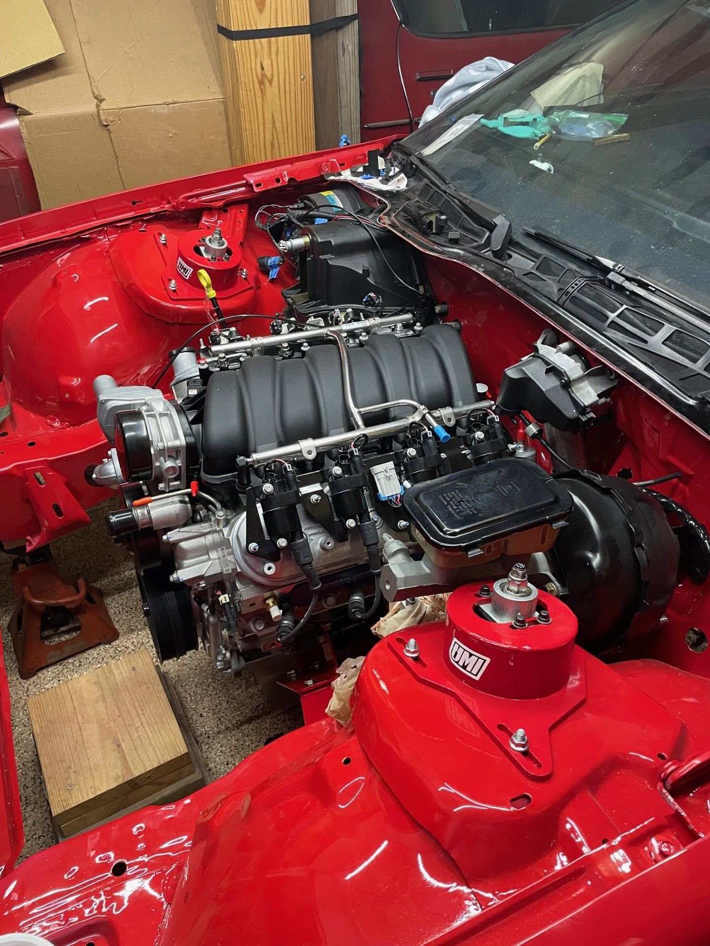

I'm deep in the process of LS427/570, Tremec T56 Magnum F swapping my 1987 IROC. Both are in the car right now. The car currently has KYB AGX struts up front and shocks in the back.
I've got all UMI suspension up front and in the back. Road Race K Member, tubular, delrin bushed control arms, and weight jacks with 850lb springs. In the back, I've got roto joint lower control arms and Eibach Sportline springs that were on the car when I bought it. I'm probably going to go with UMI rear weight jacks.
I've done a good bit of reading and the Koni Yellows appear to be the way to go. On the other hand, those already paid for KYB AGXs look new. The car will be a street car and maybe I'll autocross it once in a blue moon.
