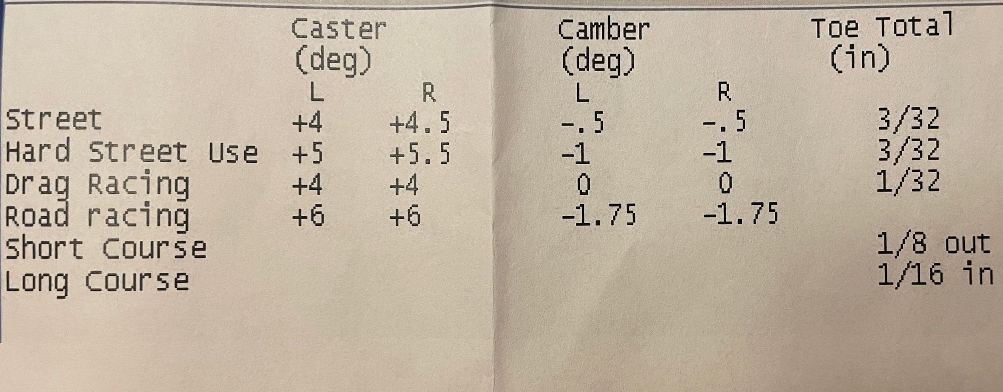

General consensus is that the factory alignment specs suck.
Below is what people here have been touting for decades.
As to the trying to turn at full lock. It sounds like a smart azz answer, but the answer is just don't turn the wheel all the way.
Old Mar 9, 2026 | 03:37 PM
Thanks! That's great info!

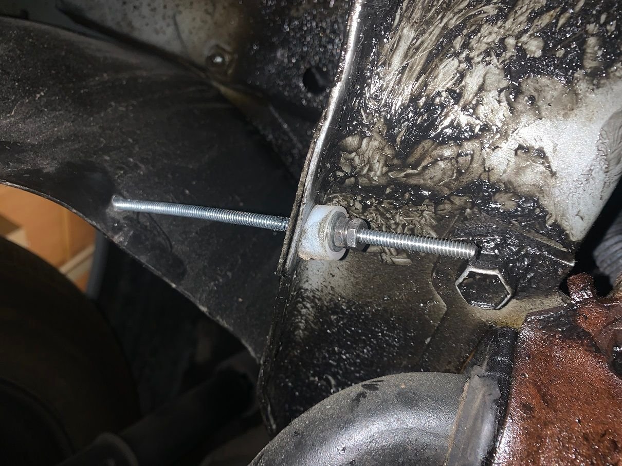

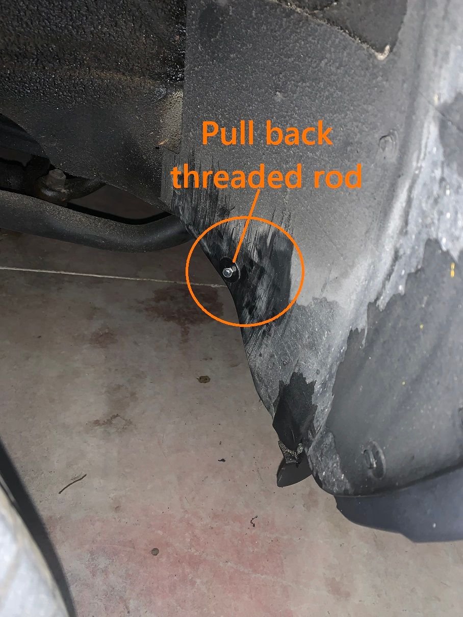

The original tires on my base Firebird were P215/65 R15 and I replaced them with P215/70 R15 tires.
Because of the higher profile my tires rubbed as well when cranked over.
I installed a threaded rod to pull back the inner fender to create the required clearance.
This set up solved my issue.
There is not much extra space in these wheel wells.
