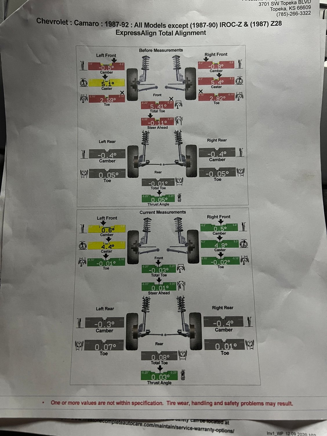

I rebuilt the steering on my '89 camaro and got new tires. 215/65/15's all 4 corners. Got the alignment done. I noticed when I pulled out of firestone's tiny parking lot that once I get to about 75% turn it starts to skip the tires and they screech. They said everything I rebuilt looked fine and the ball joints were still good, so I don't think I installed anything wrong. But it's embarrassing in a drive thru. I attached the alignment specs from firestone. I was hoping someone could give me some ideas because I have no clue what is wrong.
Above is before the alignment. Bottom is what they set it to.

My $.02- with the exception of toe, your specs were more appropriate before the alignment than after, especially the camber. The only reason to go positive camber on these cars is the reason GM did in the 80s: to make the lawyers happy, it causes the front to lose traction faster resulting in understeer and a car that is harder to wreck (and drive fast). That alignment will cause the outside edges of the front tires to wear out fast.
For street use and general handling usually shoot for between -.5 and -1* camber (the more aggressive your driving the closer you want to get to -1), just a hair toe in (set last), and as much negative caster as I can get (I'd want between -5 and -6, but by the time you set that camber most cars are limited in the caster you can get out of them, I've seen earlier third gens that you could barely get -3.5* once you set the camber without modifying things). In some cases (and areas, roads are different in different areas) you may get a little pull from the road crown, and in that case, I'd set the caster to be about .5 more (less negative) on the driver's side to compensate.

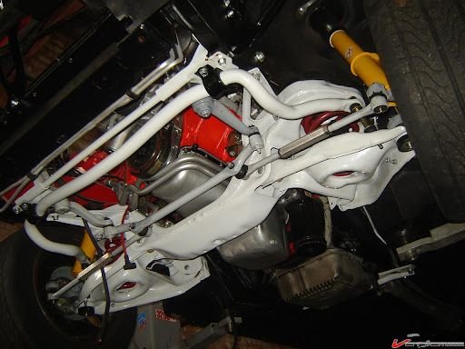

Is the center-link installed correctly?
I see backwards center-links a LOT
the inner tie rod castle nuts should face the front of the car.
If you sick your head under the bumper, the castle nuts should be facing you.
This a random pic from someone that shows the castle nuts facing the correct direction

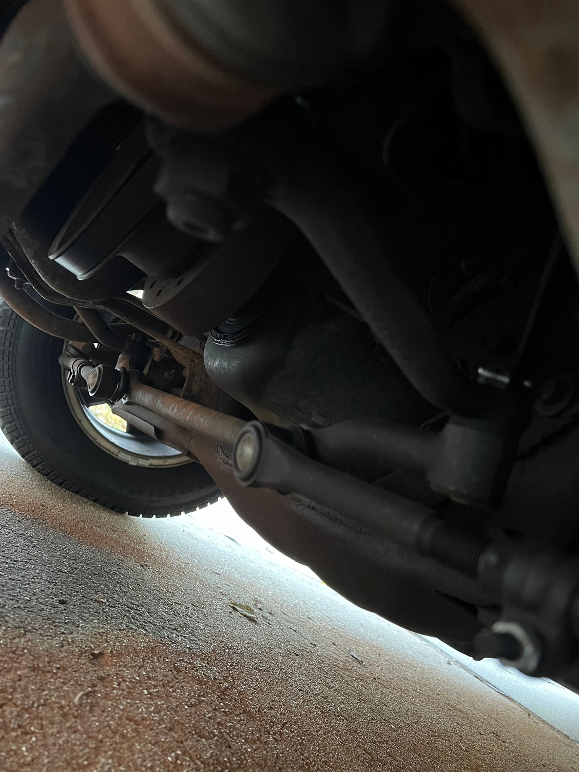

I snapped a couple of pictures. Is the center link backwards or do the inner tierods just need switched to the other side?
Sorry for the low light. It's pretty dark underneath a car.

Yup, it is the backwards. Idler arm and Pitman arm ends of the center link exchanged.
