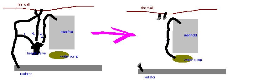

Old Mar 13, 2004 | 07:56 AM
Dewey316's Avatar
Posts: 6,577
From: Portland, OR www.cascadecrew.org
Car: 1990 Camaro RS
Engine: Juiced 5.0 TBI - 300rwhp
Axle/Gears: 3.42 Eaton Posi, 10 Bolt
i'm going to link the picture from the other post....
basicly when i did mine, i connected hose 2 and 3, with a junction behind the head. then plugged the outlet on the hose by the frame in hose #1, works like a charm, heater and everything works perfectly.
Old Mar 13, 2004 | 12:44 PM
weberusn's Avatar
Joined: Feb 2004
Posts: 120
From: San Diego, CA
Car: 91 Camaro RS
Engine: 305 TBI
Dewey,
Hey thanks for the pics. Let me just see if I have this right. When you are looking at the engine bay from the front. There are two hoses on the firewall, one behind the head on the manifold. So you connected the one behind the manifold to the the number two hose on your diagram. Then you pluged the the 90 degree junction on the framerail and that was it?
Bill
Old Mar 13, 2004 | 12:52 PM
Dewey316's Avatar
Posts: 6,577
Car: 1990 Camaro RS
yes, i got a cap for the T fitting on the frame rail. i then got a 90* elbow and used that to connect the other two hoses together.

I just read all of the stuff posted and the links, and got to thinking. Could a bad heater control valve be the cause of a re-ocurring over heating problem??? Some days my car will run perfectly but then it will start to boil over. Or am I just reading to far into this...
Old Mar 14, 2004 | 08:32 PM
3rdgenstm's Avatar
Joined: May 2003
Posts: 435
From: Huntsville, Al
Car: ‘92 Z28
Reading the other posts about this has started me wanting to do this too. My engine is pretty much stock externally, so where can I reroute the hoses? I looked at the pic links, but they didn't really show anything. I looked at my water pump today and there isn't any outlet other than for the lower radiator hose nor is there anything at the front of the intake. Is there a good schematic and/ or pics somewhere (other than those above)? I can probably figure it out, but I like to have something to reference.
