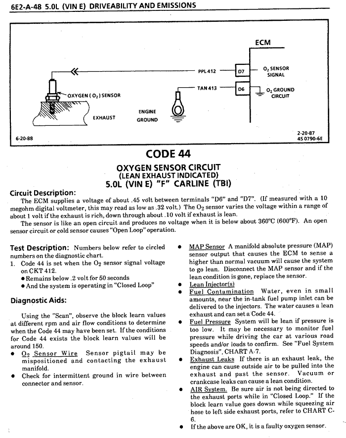

Check this chart out and fuel pressure at the pressure gauge with the engine "OFF" should be between 9 - 13 PSI.

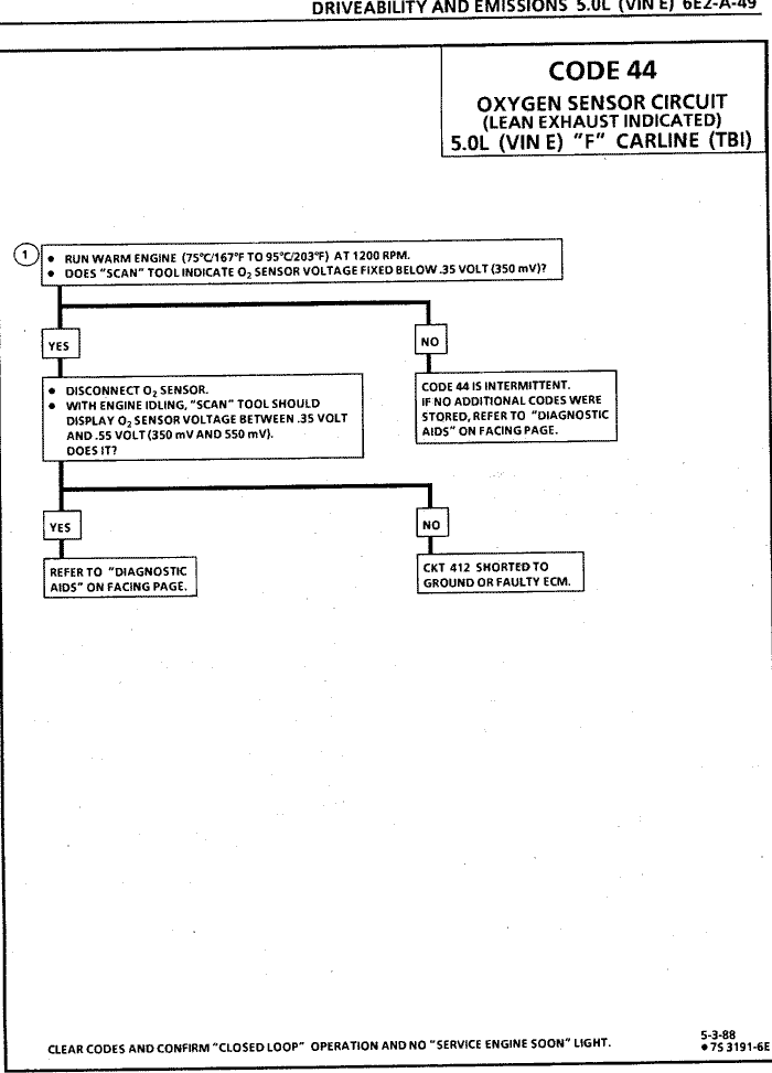

Part 2

Here is that tech info.

part 2

In my post above, you will find the troubleshooting chart for your problem. What workshop manual are you using? My information is from the GM shop service manual. The link that shiftycapone references also has the same information. What car do you have this engine in?
