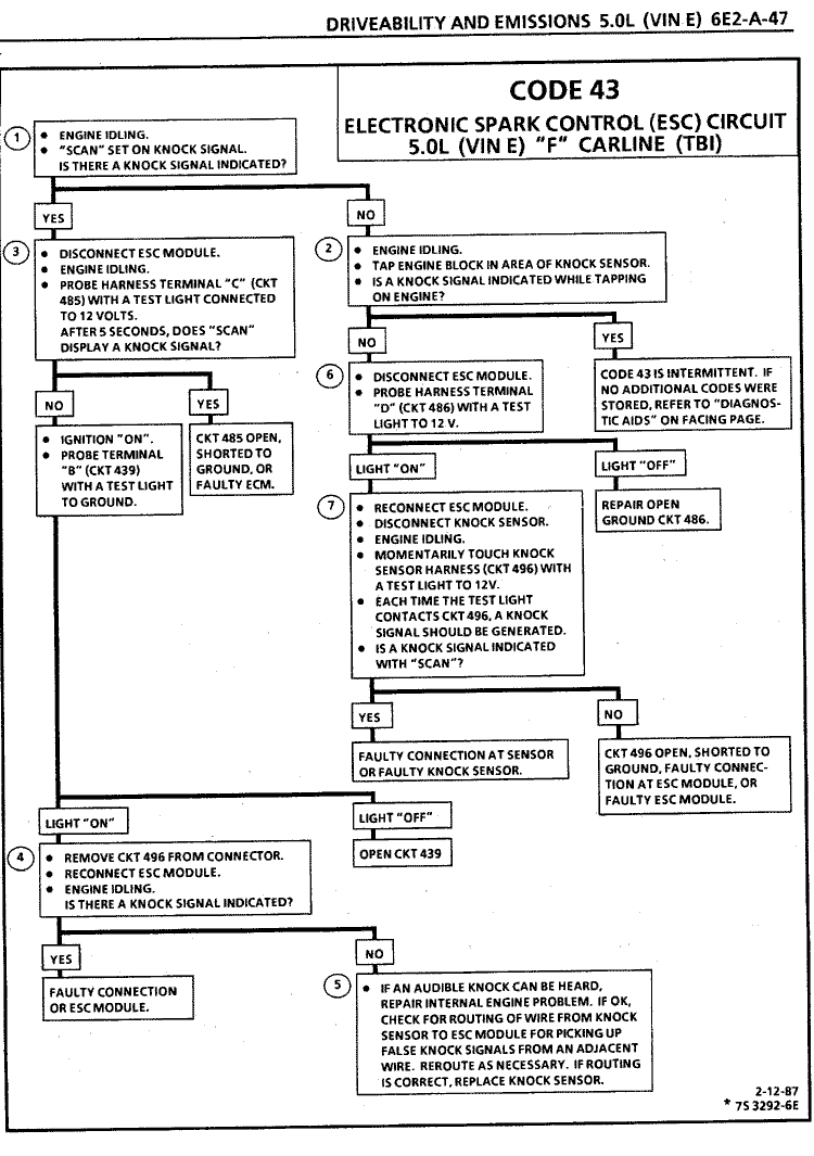

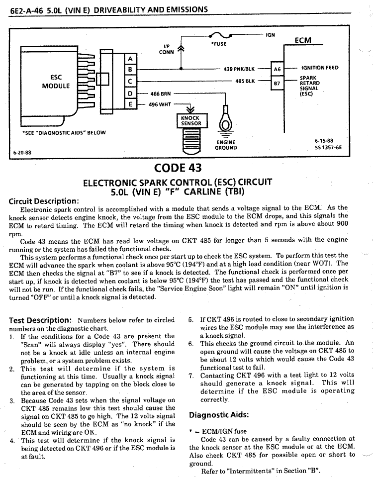

This may help.

page 2

The charts & info came from a GM service manual. Haynes & Chilton won't have info like that.

Thanks trickster for the chart. Today was the first chance I've had to mess with the wiring. I even bought a multitester, absolutley no use till I know how it works!! So I checked my wires as best as could and all seemed fine I cleaned a ground terminal on the drivers side strut. I'd hit the stage today where it was fix it, pay someonelse to or buy a knew car. I read a lot of posts on hear to do with ground terminals been corroded and causing glitchs. To frustrated to hunt down the ground so just snipped the wire and made a new ground using 16 gauge and a ring terminal to the strut. The chart you posted probably saved me a few hundred $$$ so many thanks. Do you think grounding it on the strut will be ok? If not should I just drill a hole somewhere in the firewall and attach it. Dude I'm thrilled at fixing it. Mind you in my frustration I decieded to tighten up the tbi pods/fuel regulator thing on top of the throttle body and snapped the bracket holding down the thing. My next post will read car on fire!!
