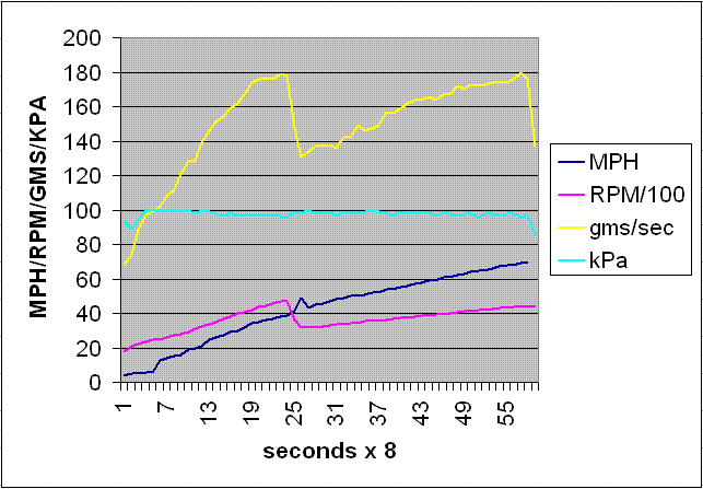

After, oh, about a year after I wrote the software so I could datalog the usual ALDL stuff at a more reasonable 8 fps I finally did some meaningful WOT datalogging. My car was having one of those extremly rare and unusual moments where everything was working properly and it wasnt broken down or in pieces. Even after nearly three years of owning this car, I can still count these moments on one hand with a few fingers missing .
Anyway, the performance was less then stellar. 3-63 MPH (cant do standing starts w/o wheel spin) in 6 secs flat. Looks like that BONE STOCK 2.8L V6 exhaust and cat that I have might be holding me back, just a little bit...
The only thing that stands out is how much the MAF and MAP outputs vary. I wouldve thought they would be more smooth. Wonder why that is? Timing issues, maybe? No audible or reported knock so that rules that out. Looks kinda funky, but maybe thats just the way its supposed to be.

Oh, the engines specs are: 350 w/ vortec heads and a performer plus cam .420/.442, 204/214 112 LSA.

MAF and MAP are both sensing things that are affected by acoustics in the intake tract -- the sound waves oscillating in the intake cause (a) pressure fluctuations (sound waves are pressure waves) and thereby cause (b) fluctuations in the particle velocity which the MAF senses. These are in addition to the ever-present electronic noise effects riding on the outputs from both sensors. You always get more noise on the MAF sensor at WOT than at cruise because the throttle blade(s) are fully open so you get a lot of sound traveling upstream from the heads/intake manifold back to the MAF. At cruise, when the throttle is nearly closed, the path is nearly choked off so you only get some of the lowest frequency sounds traveling upstream.. so the MAF sensor should look smoother at cruise. FWIW.

Another thing is that the O2 volts seem to fluctuate a little as well. Dont know how much that means from a NB but it would seem to suggest that the actual AFRs could fluctuate a couple of points with the MAF. This is definatly some sort of intake tract thing. Its at least somewhat steady under low load. Another thing is that due to the limited A/D resolution, the minimum step size around those flowrates is something like 2-3 g/s.

Got my 3" exhaust on today. The up side is the car is much better up top. Really hauls. The downside is that its too big for the current setup. The motor is really limp at low to mid RPMs now. Before it was like I had a turbo-diesel and it would take off as soon as I touched the gas. So, basically the reduced low end torque sort of negates the increased top end power.
Anyway, I got another datalog for comparison. The 5-65 time for the current setup is 5.75 seconds. Getting better...
I also noticed there is a standing wave forming in the large pipe that serves as teh intake. Its much more pronounced then it was before. kdrolt was right on the money about the 'noise' being acustical waves. Its a sinusoidal 4 hz wave.
