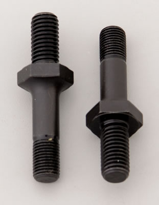

You mean these i presume...
Part Number:ARP-100-7201Base Thread Size:M10 x 1.50mmRocker Arm Nut Thread Size:3/8-24 in.Guideplate Locator Shank:YesRocker Arm Nut Thread Length (in):0.580 in.Effective Stud Length (in):1.595 in.Base Thread Length (in):0.580 in.Quantity:Sold as a set of 12.
There $50.00 scoots.
Using the new Comp cam behive spring along with those stud's should allow lift up to .550??

Yes, those are the studs I was talking about. When I looked at them they were $50 for only 6.
A Beehive spring/retainer upgrade should work on a V6 Vortec head exactly like it does on a V8 Vortec head. Not sure I'd push them as far as .550, but certainly .500 is very safe. Just watch the cost on that upgrade.
