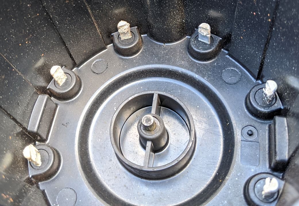

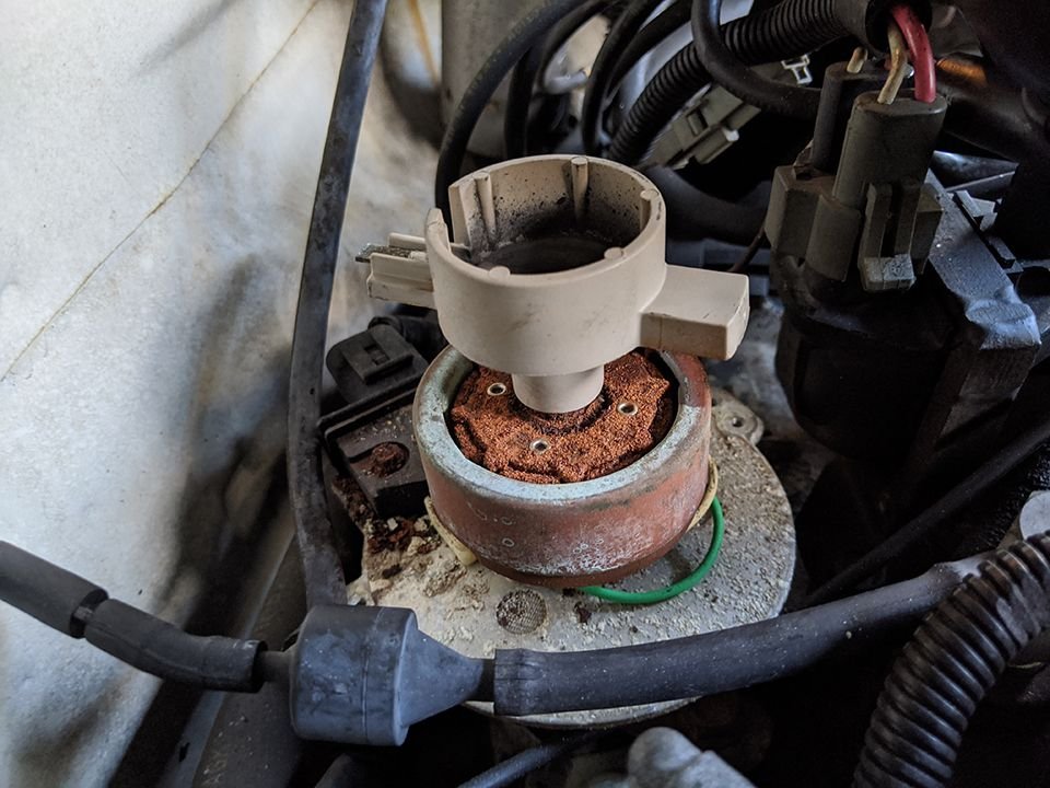

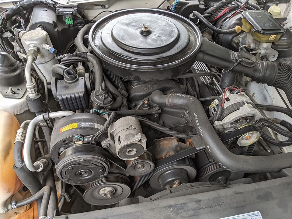

Okay, so I gave the engine a reasonably good clean (not a perfect detail or anything), here's the before:
And Here's the After:

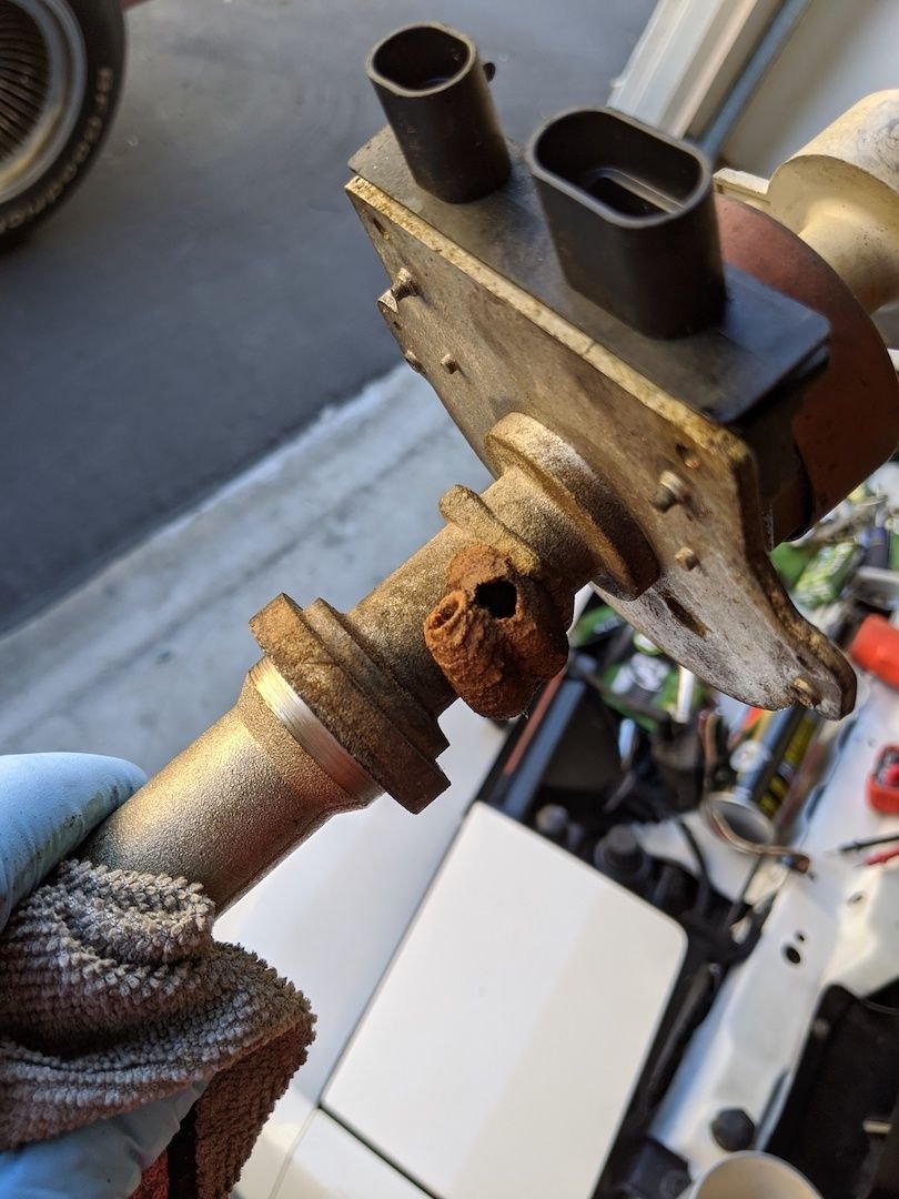

During the clean I check all of the vacuum hoses and couldn't see anything broken or damaged, there were a bunch of small annoying things like a leaky heater hose, cracked coolant expansion box, missing battery hold down and some random wires that were unplugged for whatever reason. I fixed what I could and focused back on the idle issues. I gave the TBI a little bit of a clean, there was a lot of grime built up all around it and the gasket holding the spacer was falling apart, so I cleaned up all that mess, after a good clean of everything I started the car and it still had the idle issue and a check engine light... Okay, next I popped off the cap of the distributor (Why is it so bloody hard to unscrew these things, bad placement!) and well:
I don't even know how this car was running... This looks like it was pulled from under the sea...

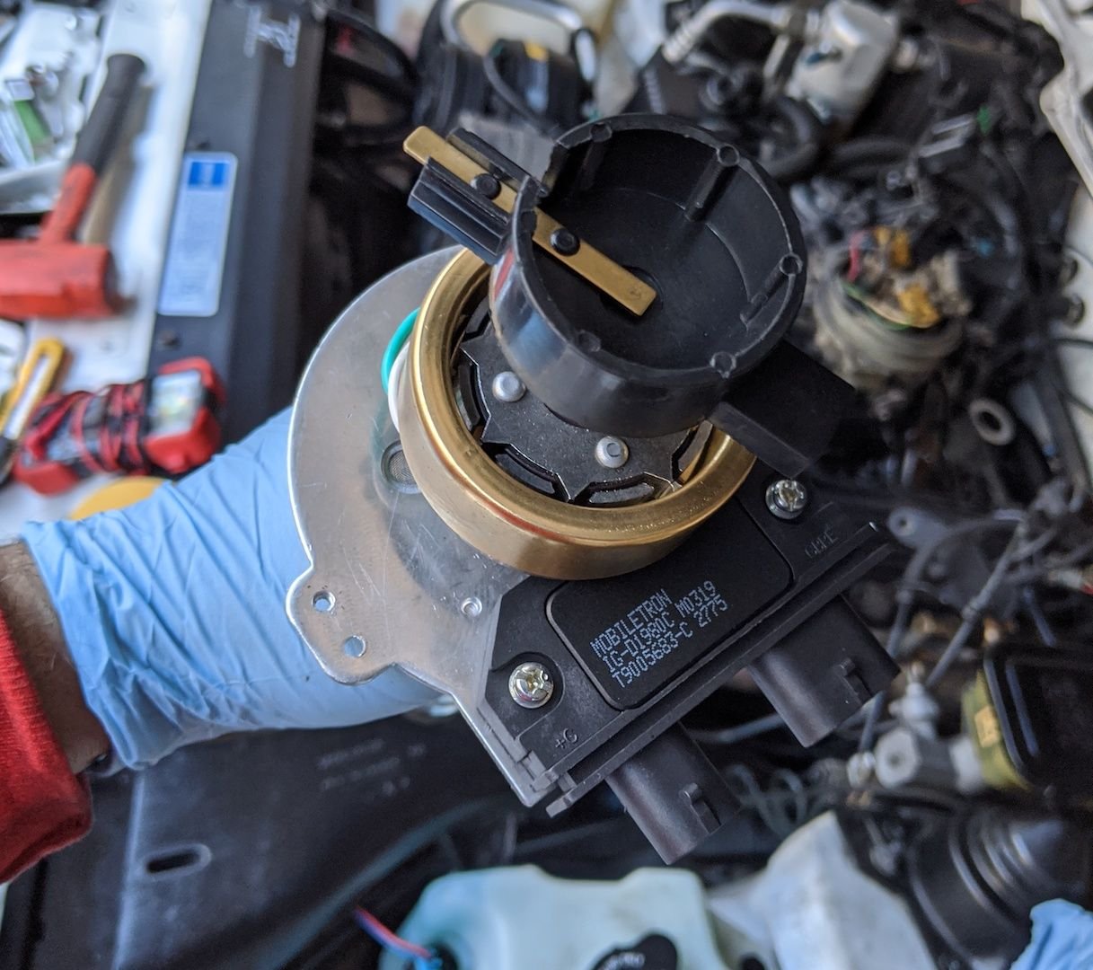

The contacts in the cap were also ridiculous! A good scrubbing, a lot of WD40 later and I put it all back, I started the car and yes it's running better! Still surging but way, way better! It's not trying to die! I'm going to order a new distributor. just replacing the cap and rotor probably isn't enough here, on a side note I got the Service Engine Soon light to bugger off finally (not sure if it'll be back), but I did this by pulling the code which was code 24 (VSS) strange since the speedo works just fine, I crawled under the car and pulled off the connector and cleaned up the huge amount of oil all over everything, reconnected it and it seems to have fixed the issue!

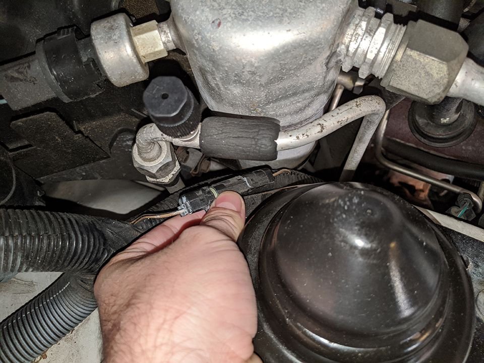

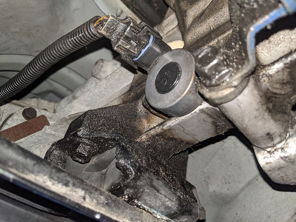

Progress so far:
Checked Vacuum lines - Okay
Reconnected a random brown and black wire that was disconnected (still not sure what it was but it looked like it should be connected, I'll chase it down later)
Checked Rotor and Cap - Completely effed up (will replace)
Messed around with the VSS connection
Result: Car is running better, still surging but not nearly as bad, Service engine light has taken a hike!

Agreed! I still have a long way to go and do plan at some point to figure out the whole data logging and chip burning stuff, I'm planning on investing a significant amount of time and money into this car as it's one of my dream cars (I'll make a proper introduction / story post at some point with a load of photos). Good point on taking photos of the wires, maybe someone here can help me figure out what they are, here's the one I reconnected:
This wire was just unplugged and they look like they're supposed to be plugged in together so I plugged it back in, it's on the passenger side next to the aircon condenser thingie, The AC works beautifully on the car so I'm guessing this has nothing to do with the AC, maybe something to do with emissions? I'd appreciate if anyone knew, also there are two other wires that are unplugged, any clue as to what they could be?:

The wire that you re-connected is for computer-controlled timing advance. You disconnect the wire to set initial timing, but it should be re-connected for any actual driving. Without that wire connected, the engine is going to run like shiit, get terrible fuel economy, not idle properly, and have poor power.
Wouldn't surprise me if the computer needs to "re-learn" some fuel and spark control if the wire has been disconnected for a long time. In other words, the more you drive it, the better it gets as the computer re-learns.

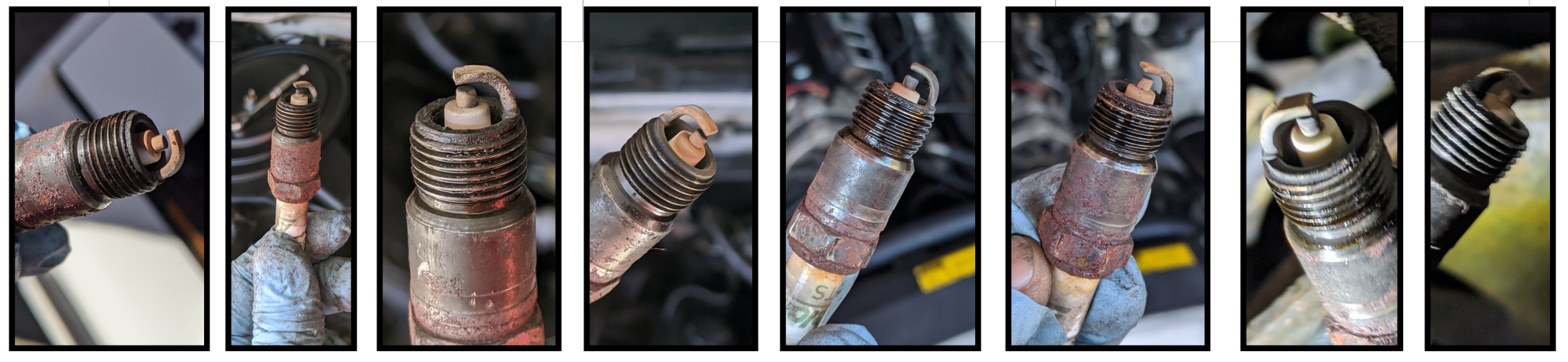

I have not given up on this, the idle surge is still an issue, here's what I've done since the last update:

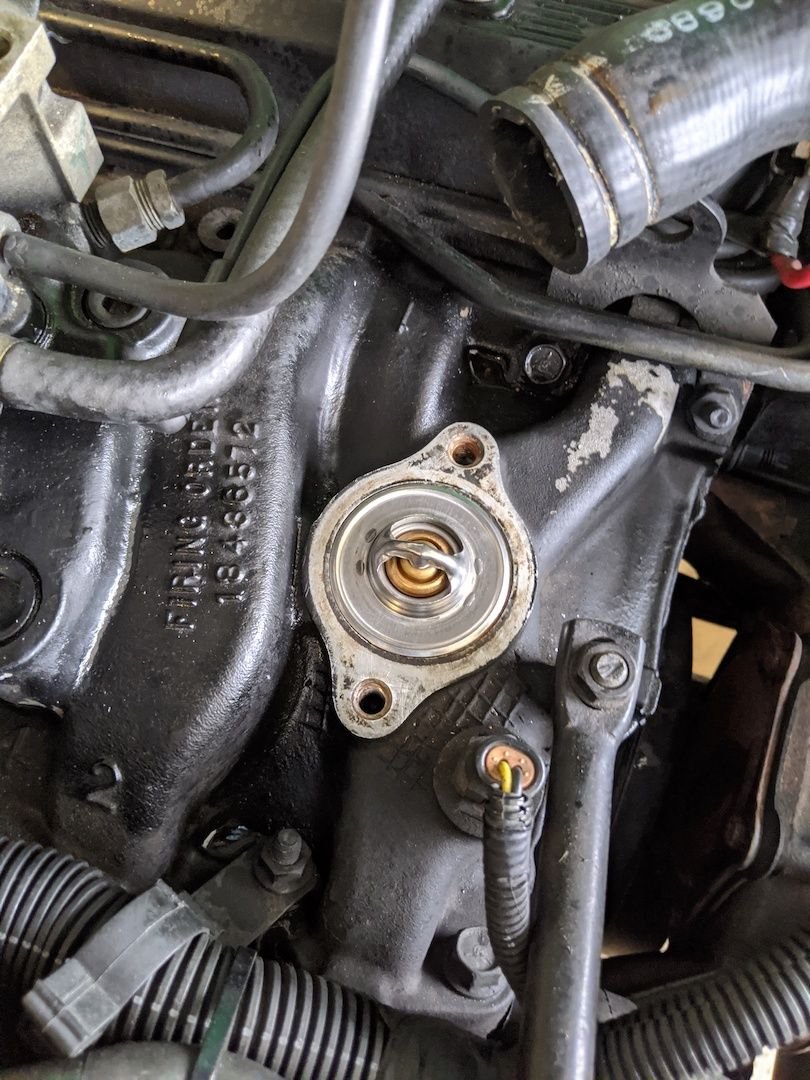

I decided to get the basics out of the way and did a full coolant and oil flush and replace (glad I did as there was rust in the coolant and the oil was watery thin... still all oil but waaay too thin).
Another important discovery is that the Thermostat was rusted open, that explains why the car was running cool and taking forever to get up to temp, so new failsafe thermostat installed:
I used Mobil 1 fully synthetic 5w30 and before anyone gives me **** about that, remember that this engine has less than 20K miles on it, if I see any leaks or seepage I'll change to a fully organic (or use cooking oil or whatever). I also opted for the bog standard Autozone coolant since I wanted to get in the zone!
My new coolant expansion box arrived from JEGS and I'm glad to finally replace the old one as it had been poorly fixed with silicone sealant and was leaking rusty water all over the battery tray (actually caused a lot of rust which I had to clean out with a wire wheel and paint over with rust converter), the old box also had a lot of rusty crud stuck to the walls so I'm glad it's gone!
Why not just replace it? This is America right? I can understand if you're in a foreign country where these parts are unavailable but seriously, just replace this crap if you don't know how to use a proper epoxy!
Waaay better! But let's be honest, a coolant and oil change are probably not going to affect the idle issue although I was secretly hoping that the stuck thermostat was causing the ECM to supply the wrong fuel mixture because of low temp readings...
I also put on new TBI spacer gaskets (above and below), the top one was missing and the bottom one was falling apart and all sorts of bits of crap were being sucked into the engine I imagine, a new FRAM air filter was thrown in too, the old air filter had oil and filth all over it:
I got these gaskets in the TBI rebuild kit which is my last resort, once I've tried everything else I'll re-build the whole thing and probably get new injectors too
And the result was that the car is actually running a bit smoother, better throttle response (not imagined) and a bit nicer to drive! BUT THE IDLE IS STILL BLOODY SURGING!!!
I've just picked up a new IAC from AutoRielly's and that's the next step I'll try, also keep in mind my new distributor has not arrived yet, I also have new spark plug wires and spark plugs on order so that will be a whole thing too when they arrive, but first the IAC and I'll let you know the results.

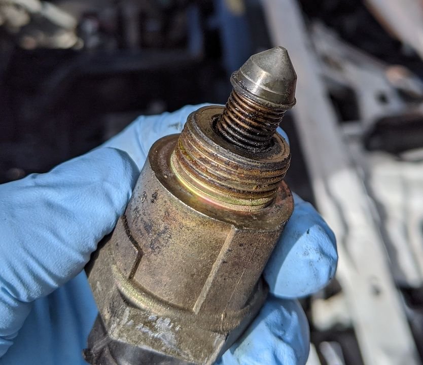

Okay, so I pulled out the old IAC and it looked gross but serviceable, either way I wanted to eliminate it so I'm putting in the new one!
whilst I was cleaning out the hole with carb cleaner I decided to do a proper vacuum test on the EGR valve since I was there anyway:
The valve held vacuum just fine and it opened when I tested it with the vacuum tester tool, however it got stuck open! Obviously this isn't ideal! I lubed it up with WD40 and pulled it closed with a pair of long nose pliers, I then worked it up and down with the vacuum pump until it was freely opening and closing without any resistance, I don't think this was the issue, but it certainly wasn't helping since it probably either wasn't opening or was opening a bit then getting stuck open... either way I could eliminate that as a potential issue. I cleaned out the air hole thing, it wasn't horrible but was still pretty dirty, here's as clean as it's going to get:
I noticed that one of the wires leading to the IAC had been chafed through so I sorted it out with a little electrical tape:
So, here's everything connected up:
So, initially when I started the car the idle was sitting around 1200rpm (which is normal since the IAC needs to sort its crap out and realise what the heck it's doing) I was excited and then quickly disappointed after a short drive the surging reared its ugly head again. I got annoyed and decided to do some spirited driving to take out my frustrations, so off I went driving around aggressively and cursing out the PO and his inability to do simple maintenance, I finally parked the car and went to do some work, later I went out for another drive and to my surprise, the car seems to idle at an almost steady pace! It's still a little low and idles at 500RPM, occasionally dipping a tiny bit and threatening to stall, but it holds and didn't die once, I took it for an extended jaunt and it seemed to keep up the good work.
Conclusion at this time:
After maintenance, replacing the air filter, breaking the EGR valve loose and replacing the Idle Air Control valve the problem seems to have mostly gone away, I'm not going to call this solved yet as the idle still fluctuates a bit and it's not ideal, I suspect that once the new distributor and plugs and wires are installed that this problem will be solved but until I do all of that I'm going to still call this problem unresolved.

Okay, back to trying to fix this idle issue! Today I replaced all of the spark plugs and that nasty distributor:
The spark plugs all looked to be in good shape but can I say something here... This is one of the worst engines I've ever had to pull plugs from! All that smog crap really gets in the way and I walked away with cuts and scrapes and a whole lot of swearing... I even had to get under the car to remove a few of them, what a bunch of bollocks!
I decided to go with E3 spark plugs this time, I know there's a lot of debate as to if these things are snake-oil or not but you know what? A spark plug is a spark plug and if it makes a spark I'm happy, especially since I don't need to gap these and on the off chance they do actually improve something then why not, I've used them in a Toyota and a Mercedes and they worked just fine, on to the distributor!
This old thing is rough, I really don't know how it was still working.. but getting it off was a nightmare!!! The hold down bolt was over tightened and wouldn't budge! I had to take off the coil and the throttle cable bracket just so that I could actually get a wrench on it that was big enough to give me enough leverage to almost burst a blood vessel breaking it free!
What a stupid design! you can't even get a socket on that bolt because of that plate overhang... Not fun!
Some sort of wasp nest... and although it was rough up top, the gear was in almost perfect shape... I had to really get aggressive sand off the remains of the gasket that had baked into the intake manifold and had become one with the steel... But since I've got all these components out of the way, it's a good chance to clean things up a bit and give it a little bit of paint:
Now time for the new distributor and time to reconnect the wires (I do have new wires but I was done with this crap for the day, those plugs really took it out of me!).
After installing everything and making sure the rotor was lined up the same as before, I got out my cheap timing light and after the engine had warmed up, disconnected that electronic timing wire thing and set the timing to "0" degrees (between that big V) since that seems to be what most people say is good for this engine:
My initial test drive resulted in the surging coming back with a vengeance at first (I'm guessing the computer is working out what all this new crap is), but overall the throttle response was better, it was easier to start and the car ran way better than before, it also seemed to calm down and come to a solid idle by the time I got home, this needs to be confirmed tomorrow when I drive to work, but this problem may actually, finally be resolved! (I'll only call it resolved if the tachometer doesn't even move a tiny bit tomorrow at idle).
Let's hope this is the end of it (I somehow doubt it)...
