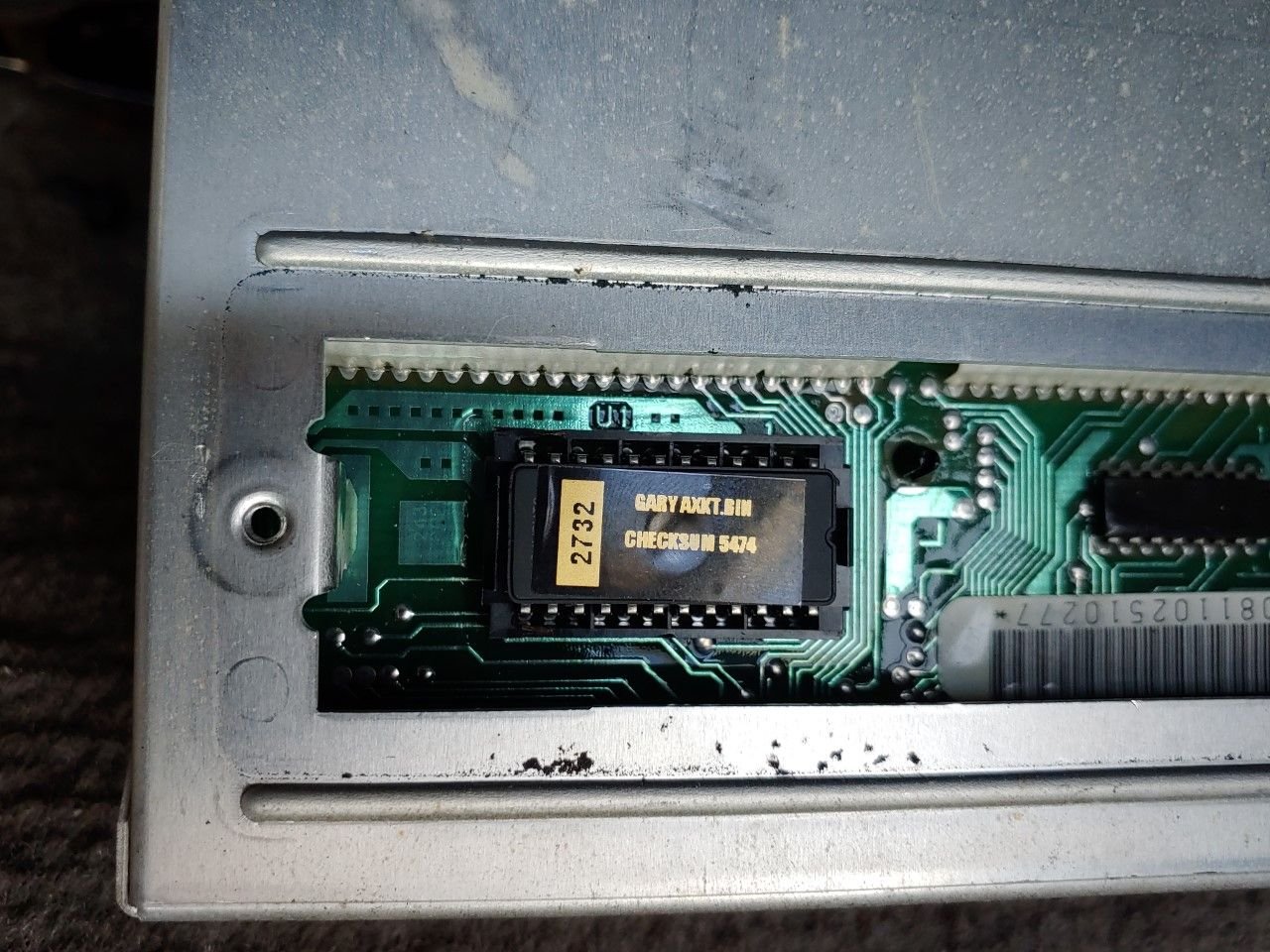

I have the computer pulled down and im ready to pull the aftermarket chip and reinstall the factory chip. will the factory chip install in the same direction as the aftermarket? both have a notch one end. I know it will install in both directions but the wrong way will fry my ecm. so which direction does the notch face? im going to pull my manual but I like checking in with you guys as well.

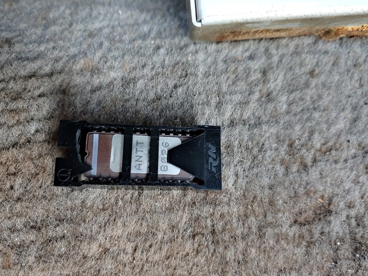

http://westersgarage.eidnet.ca/EPROM%20Procedure.pdf
this shows the direction the prom holder is inserted into the ecm. Look at the notch in the holder.

okay read the manual and went to install the chip. when I was removing the aftermarket chip I noticed one enc was very loose. im thinking maybe it wasn't seated. I guess its possible it vibrated out. the factory chip was in a plastic holder. the aftermarket chip didn't come in a holder nor did the instructions say to put it in one. so maybe the lack of the chip being in a holder is the culprit? I pushed the aftermarket chip back in and everything is working fine. im going to give it an hour then try again to see if its working. would be nice if this is just a case of a loose prom.

took the car out for about 15 miles. it ran great with none of the issues. im hoping that the loose chip was the issue and this will stay running right. last time I unhooked the battery the computer reset and it ran correctly for about 5 miles. I feel like ive driven far enough that I would know if it was going to fail again. will find out for sure tomorrow.

Can’t believe someone sold you a prom without the holder. It really helps secure The connection.

I have some errands to run tomorrow. it will be plenty of miles to know for sure if ive got this thing beat. need to buy a holder for this chip.

Look at the junkyard for a holder 87-92 tbi trucks they are behind the glove box insert.
i have some but only have flat rate small shipping boxes so shipping would be a killer for such a small part.

Im far enough into driving miles now to say this has been corrected. The prom had vibrated loose on one end. I guess this is a best case. For now im going to tuck everything back under the dash. If this happens again i will need to locate a holder. Thanks to everyone who jumped in with advice to help me keep my bird flying.
