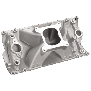

Just to update on that: I'm getting a Professional Products Hurricane in next week. Got a nice deal on it from a guy here on TGO and he said the ports match up well.
What it looks like:
So that means the one I'm getting is unheated.. oh well. Shouldn't be too much of a problem since I'm running an open air cleaner and stock hood (no cowl). But I'm tuning with the EBL.. so I'm better off as far as tuning goes?? Not familiar with the setup described, and I'm running MAP
