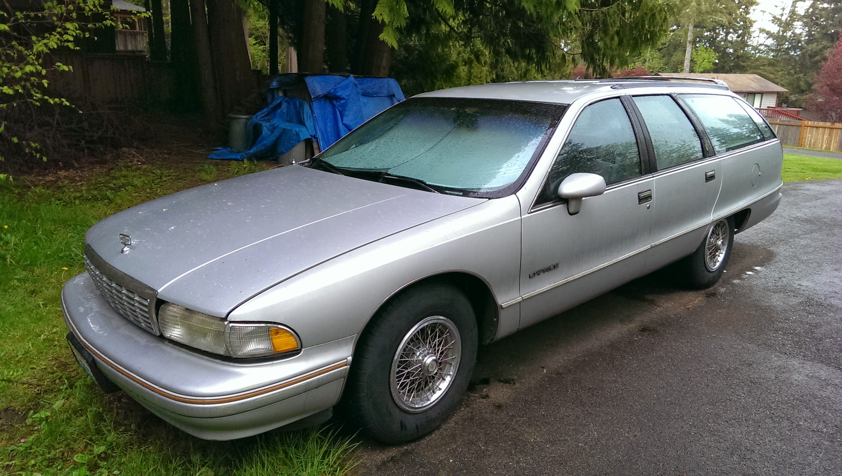

So I know this is a Camaro forum, but there is lots of information that is common between Caprice's and Camaro's of similar years. And as another post stated this forum comes up regularly when searching for 350 engine swaps.
I have a 1991 Caprice Station Wagon with an original LO3 305. The car has been in the family since mile 1 (dad bought it off the lot) and I've been thinking about an engine upgrade for a long while. It has 339,300 miles on it and died on me while driving to work about 5 months ago. I went through a number of parts troubleshooting and replacing (coil, distributor, plugs, wires, hoses etc.). I was able to get it running again but can't get it timed correctly, so it runs terribly (hesitates, misfires etc.). There is a very large amount of timing line wander when using my dial back light which leads me to believe that the timing chain probably jumped a tooth (it's the original sprocket and timing chain). If I were to replace the timing chain and sprocket, it appears to be a good percentage of getting the motor out of the car and there’s no saying when the next big event would force me into an engine overhaul or replacement. This event seems to be a good “pivot point” for a new engine.
This brings me to why I’m writing this post. I've been lurking around this site and others like it for a month or so now and am starting to formulate a plan for a motor swap. The intent is to change the LO3 out for an L31-R Vortec motor. There appears to be a lot of good advice being given here especially in these threads.
My plan is to swap out the motor and, while in there, swap out a number of other components or systems for upgrades that I've been thinking about, planning and saving for for a long while. The highlights are as follows:

The vehicle has been a daily driver for years and I'd like to keep it that way. It has towed a number of things in the past, but probably will not need to in the future since I now have a truck for that. I also have a 1993 Buick Roadmaster with a 350 and although they appear to be the same vehicle from the outside, they are worlds apart when it comes to power and drive-ability. It would be very nice to get my Caprice closer to that level (or even beyond).
I am not a novice at working on cars and have a small fleet (7) that I maintain pretty well, three of which are 90’s GM TBI vehicles. However, this will be my first engine swap and I’m looking for some advice from some of the more experienced folks here.
Attached is a spreadsheet that I’ve been compiling my parts list on. It also has my calculations on injector sizing, my build plan and a list of questions that I need help with. My intent it to keep very detailed records both written and pictorially and, if desired, share them on this forum. Hopefully my experiences can help someone else.

It's been slow progress since I posted last. Basically I have an empty, clean engine bay waiting to be filled.
Am getting started on new suspension parts right now and am about to start buying engine components. Thinking/reading a little bit more, I'm starting to consider a 383 option. Fast, do you have any links to the Marine 6.2 option you recommended? Am curious about price. Would I still be able to use TBI with the GMPP TBI Vortec manifold and RBob's EBL Flash?
Certainly want to upgrade my stock 700R4. Any suggestions on a builder who makes one that will stand up to the 383's torque? Would my differential need an upgrade for this sort of power?
Fast, I'm curious about your previous comment about exhaust. What's the difference between headers and the LT1 manifolds? Does one perform better or is quieter? I was planning on leaving the AIR system off once everything is back in the car.
Am still aiming for decent mileage and using this a daily driver with the occasional tow of a car or my tractors.
