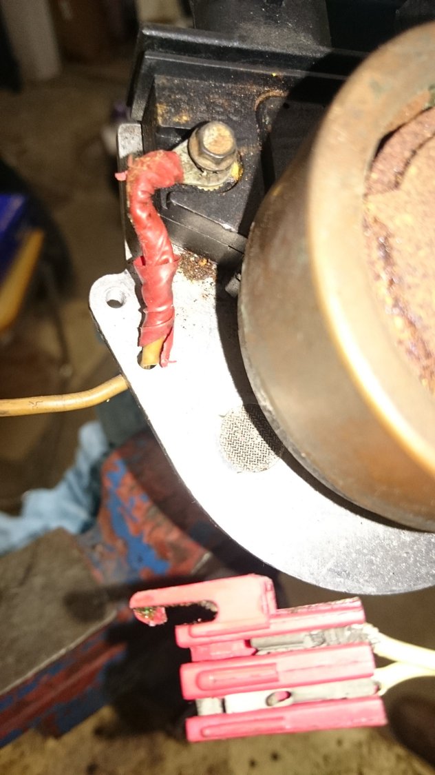

Anyways, a better inspection of the distributor inners revealed a couple of possible causes for the stalling and no DRP condition (to me anyways).
- Pickup coil connector having a wrong pin terminal, easy to get a bad connection here.
- one threaded hole to fix the ignition module to the distributor base for electrical and thermal contact is no more threaded, i could pull the small bolt out by hand
- To that bolt, a separate ground strap was attached, that goes through a hole in the distributor base and connects to the engine block.. Also quite strange and prolly jerry-rigged, too? What's the usual method to connect a ground here if there is one?
That said, pickup coil output with DVM checked out ok as per above site. Need to fix these "mechanical" issues first and i think that might already solve the stall issue?
Likely. I think you found it.
A longer screw, and a nut on the underside of the housing would work. A larger screw, and tapping the housing for the larger size might also work.

Unless I misunderstand, you need a replacement pickup coil to get a satisfactory harness; and so far as I know the pickup coil is not offered without the entire distributor shaft.
Once you price the distributor shaft...one wonders if a replacement distributor isn't in order. I suspect you'll find that the distributor shaft new costs about the same as a rebuilt distributor, and more than a used distributor. Of course, your location may change that.
The distributor parts MUST be for the V-6.
http://www.rockauto.com/en/catalog/c...ckup+coil,7176
Btw, I was just checking out the parts compatability list and saw that many many GM HEI model can use a pickup coil like the ACDelco D1987.. also those that were only offered with a V8, so I'm thinking any pickup coil would be fine?
Thanks on your pointers for the 'mechanical' issues.
Will report back after achieving some progress.

Re: rich exhaust code, lean pops
Thanks for the link. Now I'm gonna have to figure out how the pickup coil comes off.
Since that style pickup coil doesn't include the timer teeth like the ones I posted earlier, cylinder count is unimportant.
One wonders how or if the magnets can be replaced. The magnets, wire coil, and outer timer teeth are an assembly on the earlier pickup coils. Not so with these.
Old Nov 3, 2016 | 09:21 AM
Yes, that pickup coil is the correct one for the 4.3l engines. The 4.3l distributor is nearly identical to the SBC small cap distributor. Only difference is in the star wheel tooth count and the number of reluctor poles. The shaft with the magnetic star wheel is also available on RockAuto. If the magnet is falling apart or heavily cracked it would be worth replacing it too.
If the current ICM is an OEM unit at the least I would keep it. Even if replaced by another AC Delco ICM.
Note that the hole in the base plate that they passed the ground wire through is a locating hole for the cap. The cap has pins molded into it that fits those holes (one on each side), to accurately locate the cap on the distributor.
To get the shaft out of the distributor a carb gum cutter works wonders to cut through the varnish build up. Otherwise it can be impossible to very difficult to get the varnished areas of the shaft past the bushings. Berkebile 2+2 comes to mind.
RBob.
@Schurkey, as said there's a roll pin down there in the gears that you have to remove, if the shaft isn't all coked up with oil varnish it will come apart that way rather easily, if not it needs a little persuasion with a hammer or the like.
On the coil insides, I saw a video on youtube somewhere that shows how to disassemble a pickup coil with the parts you mention.
(Might have been this one here:
@RBob, thought so on the SBC small cap similarities. So the shaft and magnetic star wheel would be different, read more expensive, for this V6 then, making a new/rebuild/etc distributor more cost efficient. Can I check for cracks in the mentioned star wheel and its magnets without unmounting shaft, pickup coil and the like?
Not sure if the ICM is an OEM one, how would I tell?
I'm planning to keep all components that don't need immediate replacement.
I was not aware of that hole being a cap locating hole/pin thing. However I did think the two screws on the cap would position and hold it down sufficiently. But then again I did see some timing jumps..any relevance here?
Good point on some aggressive carb cleaner thing spray for removing the shaft..
The shaft (pole piece) is listed at $91 on RockAuto. The part I don't like about reman distributors is that you aren't sure what you are going to get. And unless it was done by AC Delco you aren't going to get an AC Delco ICM.
Yes, I used a red arrow on your picture to show where the magnet is. It is clamped between the two pieces that are riveted together. It should also be visible around the shaft.
See if it has AC Delco or the numbers 466 molded into it.
Probably not related to the timing jumps, but the dowel pins do make sure that the rotor and cap terminals are properly aligned.
It makes it so easy to pull the shaft. Also good for getting varnished lifters out of the bores. Sure beats using a F*rd tool.
The video posted is from an older, coil-in-cap V-8 HEI. While they "can" be disassembled, they shouldn't be, as it's somewhat difficult to get them re-aligned again--and--the replacement is sold as the complete assembly anyway. If the pickup coil or the magnet has problems, you're going to toss the housing, magnet, coil of wire, and pole piece in favor of a complete assembly.
Turning the magnet upside down causes problems, too.
I'm still looking for instructions for replacement of the pickup coil on the small-cap TBI distributors.
For the record, i fixed the pickup coil connector and cleaned the distri base plate, reapplied thermal paste and properly remounted the icm.
It would run a little longer that way but still stalls out with no spray condition after about 20 minutes.
Put an AC DVM to the pickup coil wires and it reads the voltage as described in that Test i linked to above. So ordered a new ICM now.
Seems legit I guess.
