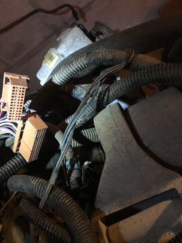

Re: New to tbi conversion help
Here's a pic of the plug to the ecu,

Originally Posted by 91dime
Talking with some guys on a squarebody forum, they believe I need a 16147060 pcm.
The connectors show that it uses the '7060 PCM. Used from '91 through '93 (maybe '92?) with the 4L80E transmission.
Will I need to have a chip burned to get those controls removed so I won't have a SES light on all the time?
Yes.

Old Dec 1, 2016 | 11:38 AM
91dime's Avatar
Joined: Feb 2007
Posts: 151
So the 7060 will work with the manual after being burnt? Does anyone on here do that, or will I need to find a shop to do it?

Old Dec 1, 2016 | 01:38 PM

The other thing you can do is to find a '7747 ECM and use it. The two tan connectors can be used with some mods to the 'keys' on it to allow them to plug into the '7747.
However, you will need to re-pin the connectors to match the '7747 pin out. They are different so don't mod the connectors and plug in a '7747 without re-pinning. Unless you like smoke shows...
There are many stock PROMs for the '7747 that match the truck engines.
