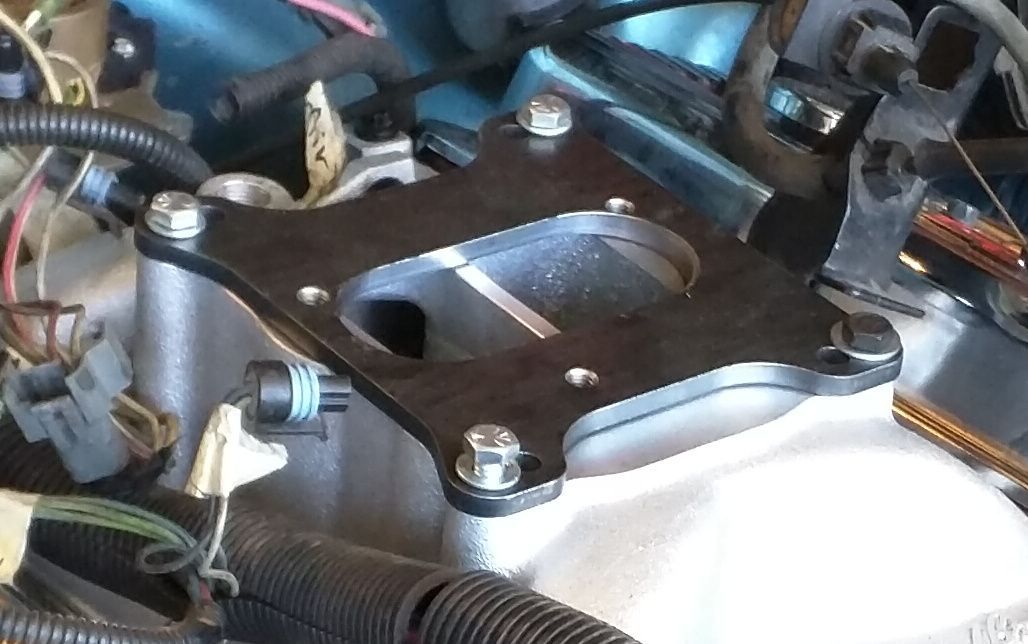

I've been collecting parts for years to make this build happen. This all started as a budget build from a set of 062 vortec heads I purchased for $100 off craigslist about 8 years ago. I then picked up a Vortec 350 for another $200 with a cracked head. Once my 700r4 started slipping the top of 2nd gear I abused it to its death. One day I only had 1st gear and reverse. That really set this project in motion for the last year and a half. My L03 is still sitting her in the garage with about 200k on it. It still ran strong and is one of the most reliable engines I've ever had. I feel bad pulling it since its been so good to me over the years but I needed a new power plan so now was the time. I didn't go LS for couple reasons. 1. I really love that classic small block sound. Nothing sounds better in my opinion. 2. I was on a budget and picked up parts a little at a time until it was possible. Everything from headers back to the rear end was setup for this in mind. My main goal is > 300whp or just under 400fwhp.
My Build is as follows:
350 Vortec 880 2 bolt main block 167k miles from a 96 Tahoe (rings, bearings, Honed cylinders, all new gaskets, oil pump)
Re-used stock Crank, rods, and pistons.
Comp pushrods
GM Single roller timing set
062 Vortec heads from a 330 horse crate motor. Valve job, new seals, LS3 springs and Comp 787-16 retainers
Felpro 1094 steel shim gaskets
Approx 9.6:1 compression
Lt4 Hot Cam
GMPP 1.5 Self Aligning Roller Rockers
Edelbrock Performer 2116 Intake
Modified Transdapt TBI adapter
454 TBI, large base footprint, 17084304 injectors (scored at the junkyard for $25. Lucky me.)
Swapped throttle linkage from SBC TBI and welded it on for 700r4 TV cable.
14 Inch Edelbrock with K&N (touches hood insulation but the hood shuts!!)
Hooker 2055 Headers, Y Pipe, 3" inch Catco cat & 3" Dynomax catback
Rebuilt 700R4 with shift kit, 2025rpm Precision converter (was free). I need to return to my trans guy to make it shift higher. Currently shifts 4400 - 4700k RPMS. He gave me weight and spring kit just need to go back and get it tuned. I just wanted to get the fueling as close as I can before going higher in rpms.
10 Bolt Rear with 3.42 gears, Eaton Posi and Moser axles.
ACDelco 241 fuel pump
Founders LCA's and Panhard rod.
Questions:
Which adapter plate should I use for a large base footprint 454 TBI? The one I have now is leaking at the IAC. The one I have is a transdapt for a smallblock TBI but has been machined out for 2" bores. It's centered on the manifold. I've seen front and rear mount but cannot find another 2" adapter that is centered.
I have the 28psi spring plus the 17084304 injectors. Are the 17084304 454 Injectors 75lb/hr or 80lb/hr? I keep seeing both all over the internet and I need to know which I should set for the BPC in the EBL Flash calibration. Right now its calculated for 75lb/hr and 28psi.
I'm running somewhat rich at idle and getting black soot in the driveway after startup. My wife hates it. It idles pretty good and sounds awesome. I know part of this is tuning but I often wonder would going to a vacuum referenced FPR help with that because the fuel pressure would be lower at idle? I'm thinking the Aeromotive AEI-13301. I wouldn't mind putting a FP Gauge too. Does anyone have a list of proper fittings for TBI?
I'd like to raise my shift points to 6000k rpms 1st to 2nd shift. Maybe 5800k or so on 2nd to 3rd. Does this sound good given my setup?
I have my base timing advanced but I cannot tell exactly how far advanced it is because the vortec plastic cover only shows a mark at 0 degrees. It seems to like base timing a bit advanced but its not accurate for tuning. I'm pretty sure its > 6 degrees advanced. Should I set this back to zero and just let the EBL do its thing? The reason I ask is because I keep getting spark knocks and I have been retarding those cells in the SA Main table over and over again.
I also plan to purchase a wideband o2 for further WOT tuning. Any suggestions?
All in all the car seems to run okay and is a nice upgrade from the L03 but I know its missing power. I realize this is in the tuning and other things but I need to get the TBI and adapter setup right and go from there. I'm only seeing 80kpa at WOT and I've read it should be closer to 100kpa at WOT. This tells me I'm loosing vacuum and that is the next thing I'm going to tackle. I feel like this thing should roast the tires from a stop but its not there yet.
I've attached a few pictures for fun and reference. I'm looking for some answers to these questions so I can get it tuned 100%.

There is a marine adapter that fits a large base TBI but it is much thicker and would require a drop base air cleaner to fit.

I ran this intake setup on a 305 with Vortec heads and a flat tappet 216/216@ .050 cam with 1.6 rockers. It would make power to 6,200 and pulled well past 6,500 rpm.
Which adapter did you use there and is that a 454 TBI?

I am also concerned that my adapter plate does not cover the IAC entirely so there could be some lost vacuum there. See this picture from when I was mocking it up. Note there is a gasket underneath it that I cut to fit later. This is a modified transdapt sbc adapter i had machined open for the 2 inch bores. I'm looking to replace it but haven't figured out which way to go yet.
You will not go above your key on KPA reading. KPA at key on is your barometric pressure. Those of us that live near sea level are the only ones that see 100+ KPA. I have seen 101-102 KPA where I live 600 ft above sea level in the dead of winter.
