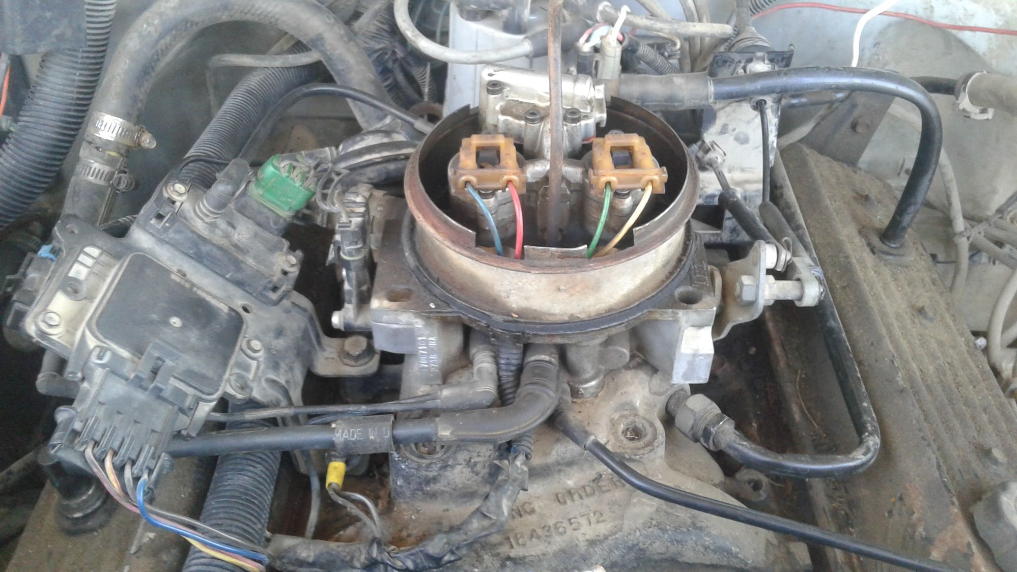

EGR valve. What is that and where? How to test idk. Throttle body sensors is the 2 yellow plugs with 2 wires on top from each? I guess I need to figure this out to get running right. Ain't got the cash to get another tbi probably. The dist, and cap and bug are 5 months old lifetime warranty and actually was installed by a licensed mechanic. Along with plugs and wires. Checked the vacuum lines replaced one with motor swap. 2 new 02 sensors on manifolds. My worry kinda is motor sat in a hay barn for 2 years. Don't know how or if they had it covered or what. Maybe run can of cfoam through oil and change oil again. It's just odd 2 brand new stats surely both wouldn't be bad to cause it to over heat like it did when I first started it with this motor. It drive great till 50mph. Got on Hwy still ran good but water temp kept rising. Got it home hottest it got was 255 and I shut it off. Go to start it back up no hot crank. So I check fluids. Let it cool down a tit go to start it. Acted just like it was out of time ya kno (vrhu..vrhu..) that probably doesn't help but it finally caught and started but idled at 1900. Temp was 140. I sat there and waited 20 min for it to finally idle down and by then it was steady slight miss at 1300rpm. So I took cap loose turnt it not even 1/4 inch clockwise. That brought idle down to a grand and didn't miss a lick. Ran smooth. Go to take off and it pulls it's (I wanna die unless u floor it) ****. So I drove it like that through all 5 gears. It only acted like that from the start 1st gear takeoff to 40mph once I shifted to 4th gear it ran awesome on Hwy. Every once in few min I could here a miss here and there but nothing like it has always done..but getting to 4th gear and 40mph it ran like junk. Went home shut it off. Waited 10 sec and it started right back up and idle at a grand smoothly. Pretty sure the blue smoke I see now isn't oil but it's fuel. I'd say since it sat for 3 months with a full 36 gallon tank it got bad and perhaps why it smells like oil more than fuel. Basically I've driven it 120 miles mostly Hwy. That full tank is now at slight above qrt tank. It got between 300 to 330 miles to full tank b4 swap. I only moved the cap once and it is marked where it was when it ran awesome to 50mph. Then gets hot. I hope this all makes sense and I really appreciate your time and expertise.

See attached. EGR valve - it is a diaphragm. You can test it with a hand-held vacuum pump. Also, get your fingers behind it with the engine
running and open the valve. Engine should stumble, or even stall. It needs to seal completely when seated. You can TEMPORARILY disable it
by pulling the vacuum line connected to it and inserting a BB in there. Then reattach the vac line.
