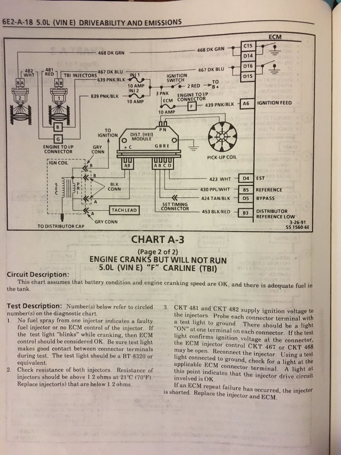

idk if it's the same as a 92 Camaro w/ the TBI 305, but i think the "hold it to the floor" method does something w/ the ECM and entering clear flood mode per my GMSM.
Btw, the GMSM will list troubleshooting for things like Hard Start - Defined as Engine cranks OK, but does not start for a long time. Does eventually run, or may start but immediately dies. I can post pics of the troubleshooting diagrams if you need...

Re: 1992 305 Pontiac idle issue
Yes it enters clear flood mode, and yes I would really appreciate it if you could send those.

Mar 26, 2019 | 09:12 PM
Reply 0
Mar 26, 2019 | 09:16 PM
Thanks!
So I disconnected the one sensor on page 2 for the set timing and had a loud pop like a gun shot and then tried starting and no start.
I've never disconnected my Set Timing Connector. "a loud pop like a gun shot" I've never experienced that unplugging anything. Sounds like a short to ground somewhere... but please be mindful, I'm just a novice w/ a service manual.
EDIT: Did you jump directly to Pg 2 under Important?

Mar 27, 2019 | 08:56 AM
The above pics are all the Hard Start troubleshooting / diagnostic info available unless a part or a problematic area has been identified. Now that I think more and more on it the root question here is not actually Hard Start or Idle related... it's why you have to use the "Clear Flood Mode" to start the car. I believe the car is supposed to run like a POS in clear flood mode, from what I understand the ECM disables the injectors so the flood can be cleared... while troubleshooting have you pulled any plugs to check for a truly flooded engine? Might not be an "Idle Issue" at all...
