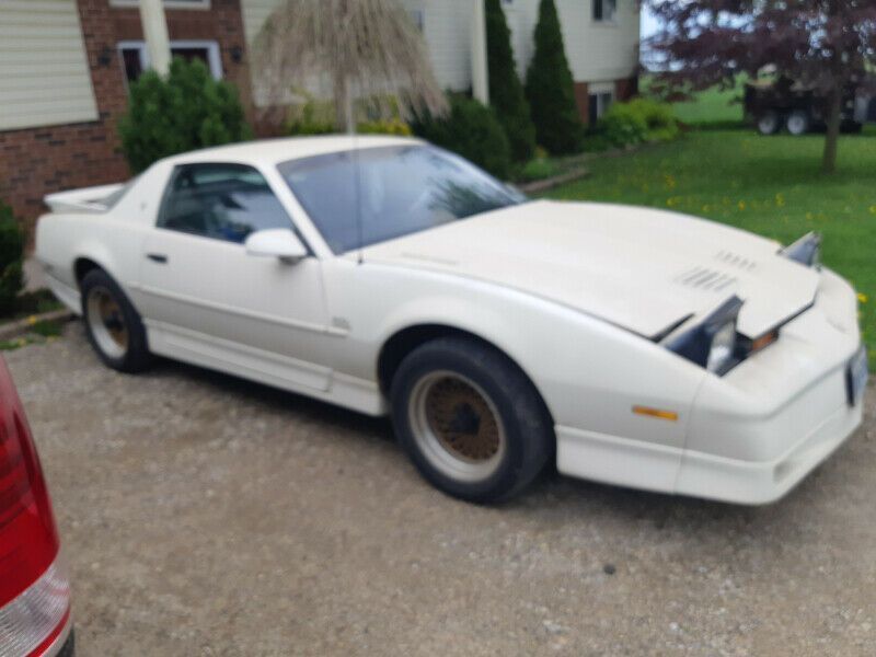

noemmisions84ta,do you remember who decoded vins for rpo options on thirdgen.org? i just grabbed an 88 gta (today,im stoked i paid $900)
and of course the console lid is gone and there's nothing in the back compartment either?i thought it was one of the mods on here,but i cant remember.
if you know,let me know.if not pls disregard
new ultra cheap gta L98
