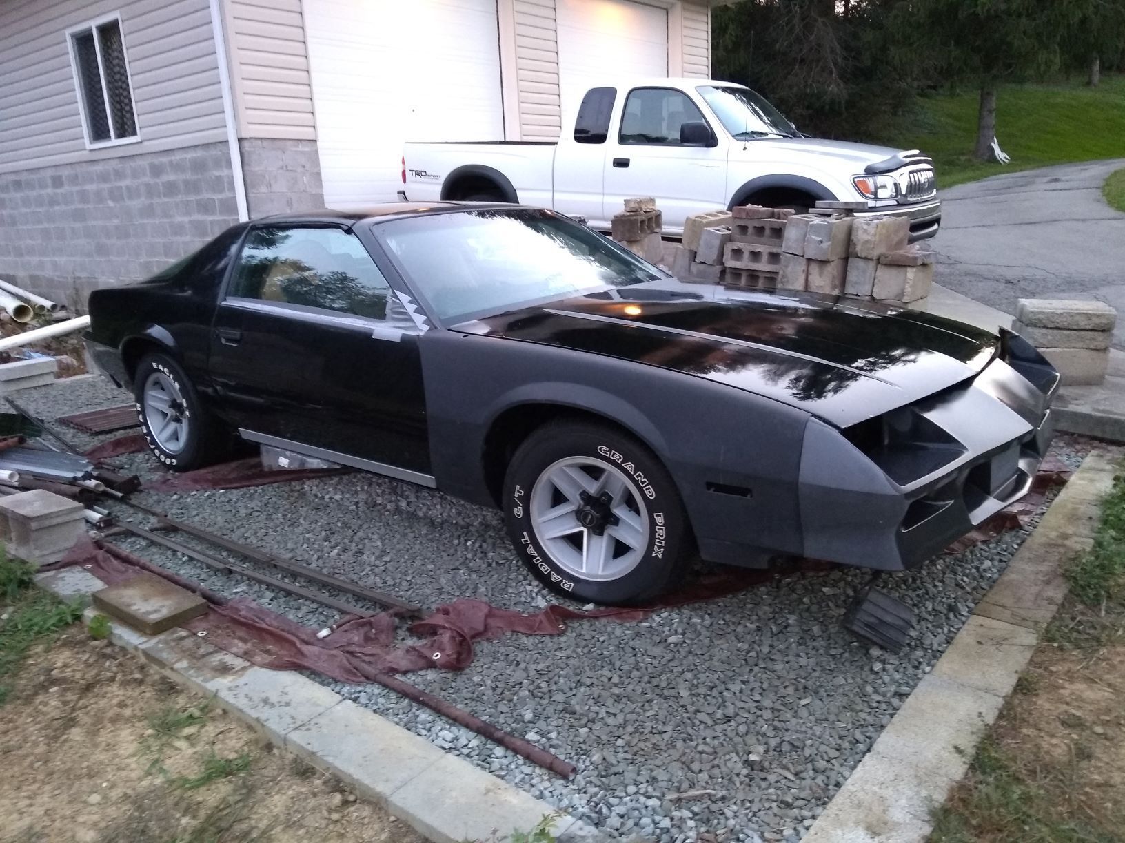

I purchased this 1983 Z28 Crossfire in 1992. It had some damage on the right front. I put a new nose, right fender and a metal hood on it and drove it for a few summers that way. Then around 98 (that is the inspection sticker on it now) I parked it and decided I would not drive it again till I could restore it correctly. Well life happens and it has been (improperly) stored in a shed with a concrete floor for the last 16 years.
Which brings me to the TBI part of the post. The fuel pump does not run. I have power to the connector. So I pulled the tank. Of course old fuel and lots of rust. So I am getting a new tank. Probably this one.

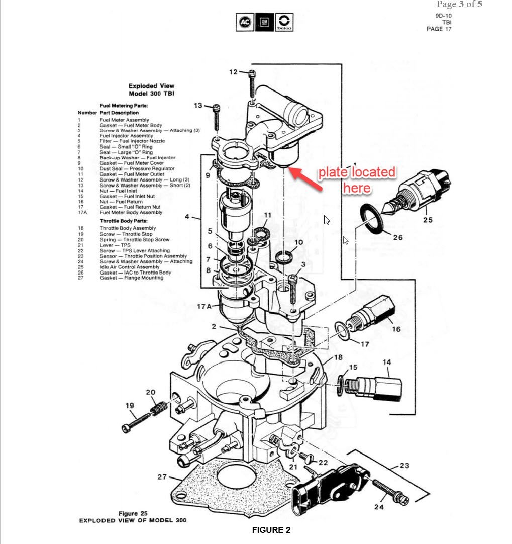

Also are there any pictures around of opening the rear TB to adjust the regulator. I have looked but don't see any. A few old posts about it but no pics.

Here is what you are looking for I believe. The arrow is pointing where the stock GM blankoff plate is located on the rear TB that when removed, you can then adjust your FP externally vs taking apart your TB each time. Just punch it out to remove. Make sure when you remove the four screws that hold the FPR together that you either hold it together real ltight or you put a small clamp on it. There is a lot of tension due to the FPR spring inside. You can strip the screws easily if not careful. GL

Yes that helps for sure. Thanks.
I have been digging around some more and found a youtube video about it too. Also determined the resistance for both the 83 and 85 sending units are 0 for empty and 90 for full so should be able to adapt the later hanger into my new tank.
