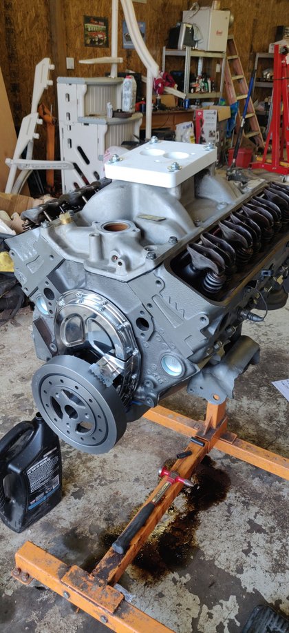

Sorry it's not in a third gen but this forum is a wealth of TBI knowledge so it seemed like my best option. I recently built an engine for my TBI pickup (1990 k1500) and will most likely need a tune but am unsure who still does them and where my best option will be. Engine specs are .040 over 350, vortec 062 heads, 88 Corvette stock hyd roller cam, jegs carb intake, eBay adapter, ultimate tbi mods, 15 psi fp spring and vortec fuel pump. Any thoughts on my best bet for a decent tune?
