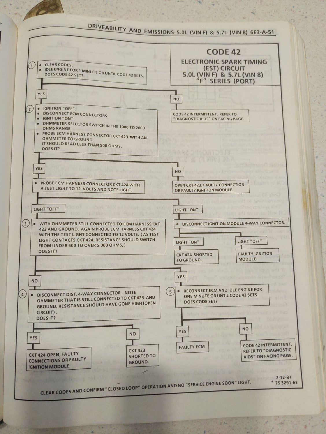

You must use a heat transfer paste between the ICM and the plate in the distributor it mounts to. ( The heat sink compound for computer CPU's works very well ) Also only use AC Delco or Delphi ones as the aftermarket ones don't last. Attached is the troubleshooting chart to diagnose the problem

I think we found problem. It is dashboard, connections are bad and someone has frankensteined the board. Now i just need to see if the ICM is bad, and if it is that was the reason.
