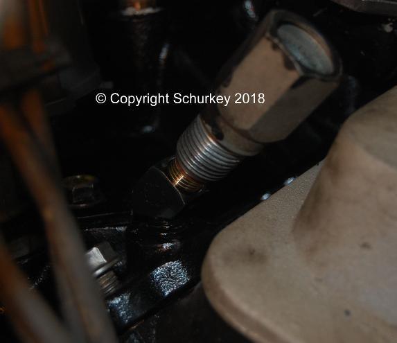

I put a GMPP manifold on my '88 K1500 after installing older-style aluminum heads. (6 bolts on each side, all at the same angle) This is the "ZZ4" intake.

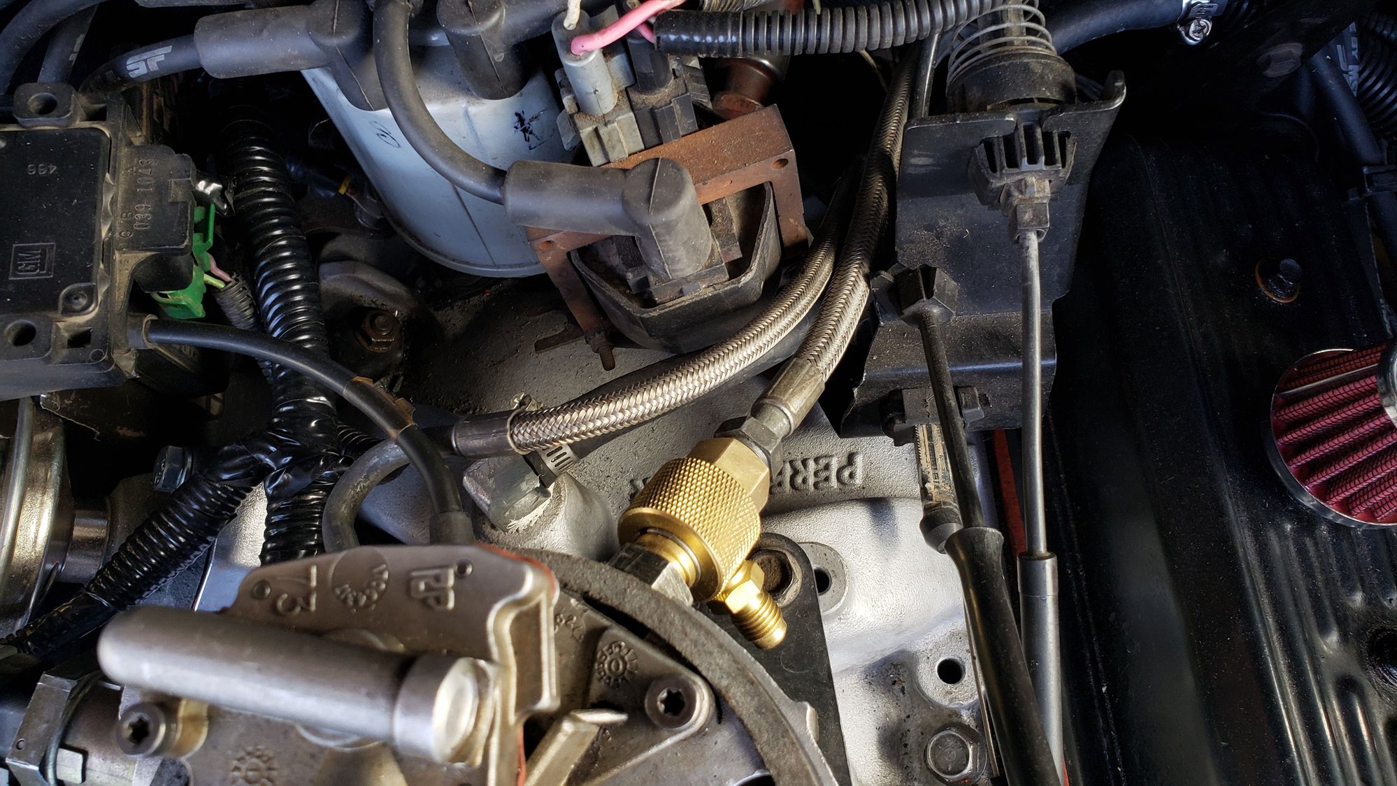

Managed to use stock EGR after making an adapter plate to go on top of the adapter you have.
Coil needed a fabricated bracket because the coil mounting posts on the manifold aren't positioned right for the stock TBI coil.
Put the MAP, EGR solenoid, and the EST module in approximately the stock location, by hanging them off of one of the choke-stove mounting bolts.
Heater hose quick-coupler got crammed into the Right Rear corner just like stock, using a brass tee, a short nipple, and some creative (internal) threading. Still have decent access to the distributor hold-down bolt.
Brake booster plumbed into manifold behind throttle body, had to bend and cut the formed-steel tube then splice it back together with a short piece of vacuum hose.
The "ZZ4" manifold positions the TBI about 1/8 inches up, and about 1/8--1/4 inch forward using a thin steel adapter plate like you have (but suitable for the spread-bore carb flange on the manifold.) Throttle and cruise cables worked fine. Had to readjust the trans TV cable.
Your manifold and mine both have the correct threaded boss beside the TBI throttle lever, to attach the alternator-to-manifold brace.
Your manifold (I think) and mine have the thermostat housing in the correct location to attach the belt-tensioner-to-manifold brace.
Neither your manifold nor mine have a suitable boss to attach the A/C compressor brace to the manifold. I still need to weld something up.
Those 3 braces are used on the C/K pickups and maybe Suburbans/Tahoes/Blazers; the accessory mounting may be different on the cars.

There's a vacuum port right behind the throttle body for the brake booster.
The coIl bolts into the same place as stock but i do need to modify the coil bracket itself on the rear for it to fully bolt on..
There's two coolant ports on the front of the intake that can be used for the heater core. I just got a 5/8×3/4 elbow and modified the stock heater hose to work. I should've mentioned that in the video in hindsight

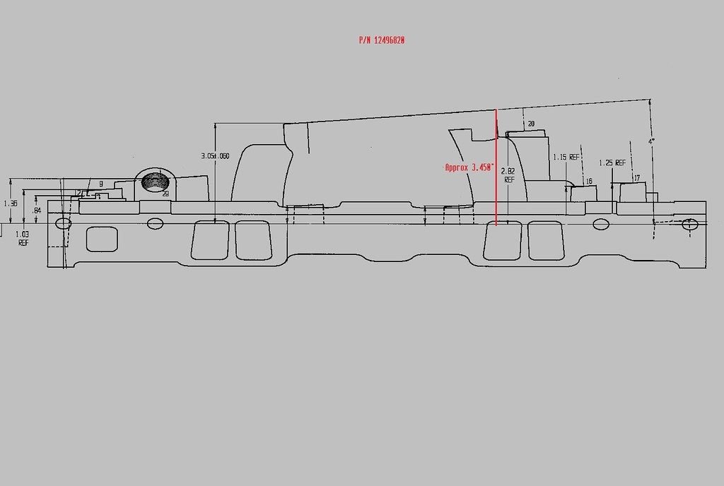

As for the height, I'm anxious to measure this GMPP intake against the factory TBI intake. Maybe I'll post a plan view if that intake and see if you guys can help me account for what on that intake. EDIT: Done. New there is HERE.
Drop a level across the throttle body flange, measure each end down to the China Rail. The front measurement is likely to be less than the rear measurement. Compare to the stock TBI manifold.
I was surprised how close the ZZ manifold was to the TBI. If it wasn't for the thin steel adapter plate, the height of the throttle body would be almost identical.

Drop a level across the throttle body flange, measure each end down to the China Rail. The front measurement is likely to be less than the rear measurement. Compare to the stock TBI manifold. I was surprised how close the ZZ manifold was to the TBI. If it wasn't for the thin steel adapter plate, the height of the throttle body would be almost identical.
Yes, I did that per the Edelbrock description.
I bought this intake based on everything I had read about it. Not the best way to do things, but I tried to do my homework.
PACE posted this GMPP drawing...

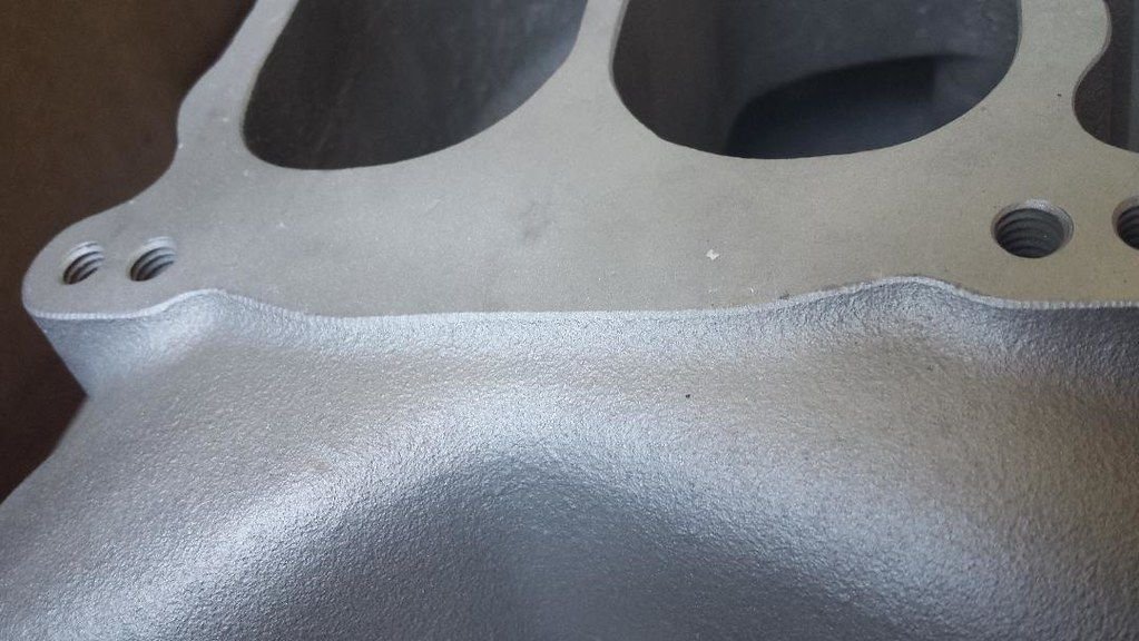

...but they took the somewhat unusual approach of measuring from the intake bolt hole center-line to the carb pad. Can't really compare that with Edelbrock, and not an easy measurement to take accurately at home on the bench.
Doing my best to keep the level balanced, a paint stick across the bottom of the intake to give me a flat "shelf", and using a stainless ruler off that shelf up to the level, I came up with 3.875" front, and 5.313" rear. Using Edelbrock's "add those two numbers and divide by two for carb pad height" I come up with 4.594".
Members have posted that an Edelbrock Performer will fit under the hood of a T/A. The Vortec Performer 2116 has a front number of 3.87", a rear of 5.28" for a calculated pad height of 4.57".
So if I'm right, this GMPP manifold will come very close to working. My plan is to create an insurance policy for clearance to the hood by A) using a Corvette drop-base air cleaner lower (based on a recommendation here on TGO), modified to accept a Rochester TBI, and B) have a friend with a Bridgeport mill off the top of the carb pad down to be flush with the runners at the front. If it's not the right tool for the job, I'll find a machine shop that can do that for me. It's not much material, and there's plenty of material thickness and bolt hole depth to take that thin amount off. I'm hoping that helps give me the space to run a thin adapter. Unfortunately it's not quite as much material as the shadow in this image makes it look like, but I'll take whatever I can get.
