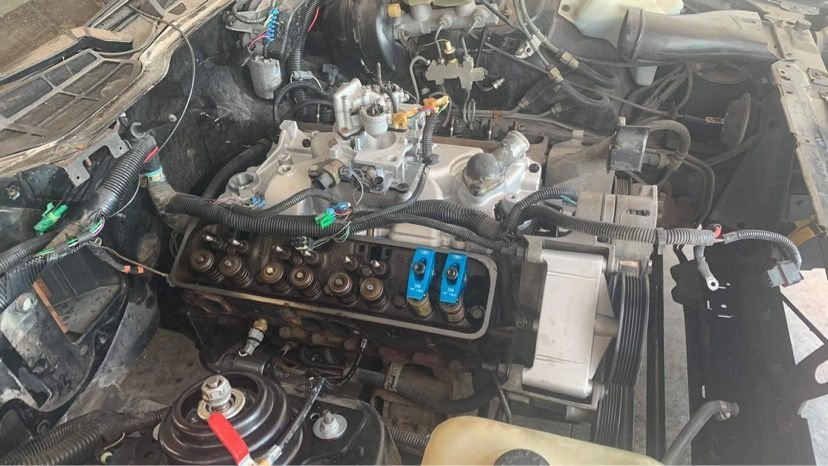

Well folks… I’m back… I took an almost ten year brake on my 1991 camaro.
when i joined the group I was in Afghanistan and when I came home on leave I picked up my all original 1991 RS Camaro.
when I got home life kicked in and I knocked a women up and well… let’s just say I’m married now and not with the boys mom 😜
anyway… I got my shop built and the car back home and it’s off to the races.
the throttle body is bored and milled, new 62 pound injectors, single plain intake, cam, springs, seals….new 3.73 gears.. Ect ect…. You get the idea…
The one question I have is has anyone ran 1.6 rockers on a stock 187 (TBI) head ?

Well I got her running tonight. It’s the stock tune on the EBL ecm so she’s super super rich (65 pound injectors and 18 psi spring) but she runs.
I went to a vortech long slot roller tip rocker so I could use the stock covers… the full rollers were 1.6 and the chance of the push rods hitting the slot in the head is high with out drilling then out…
she is NASTY with that 480/488 cam in her… hopefully I can get the laptop to connect with the ecm tomorrow and I can start tuning.
