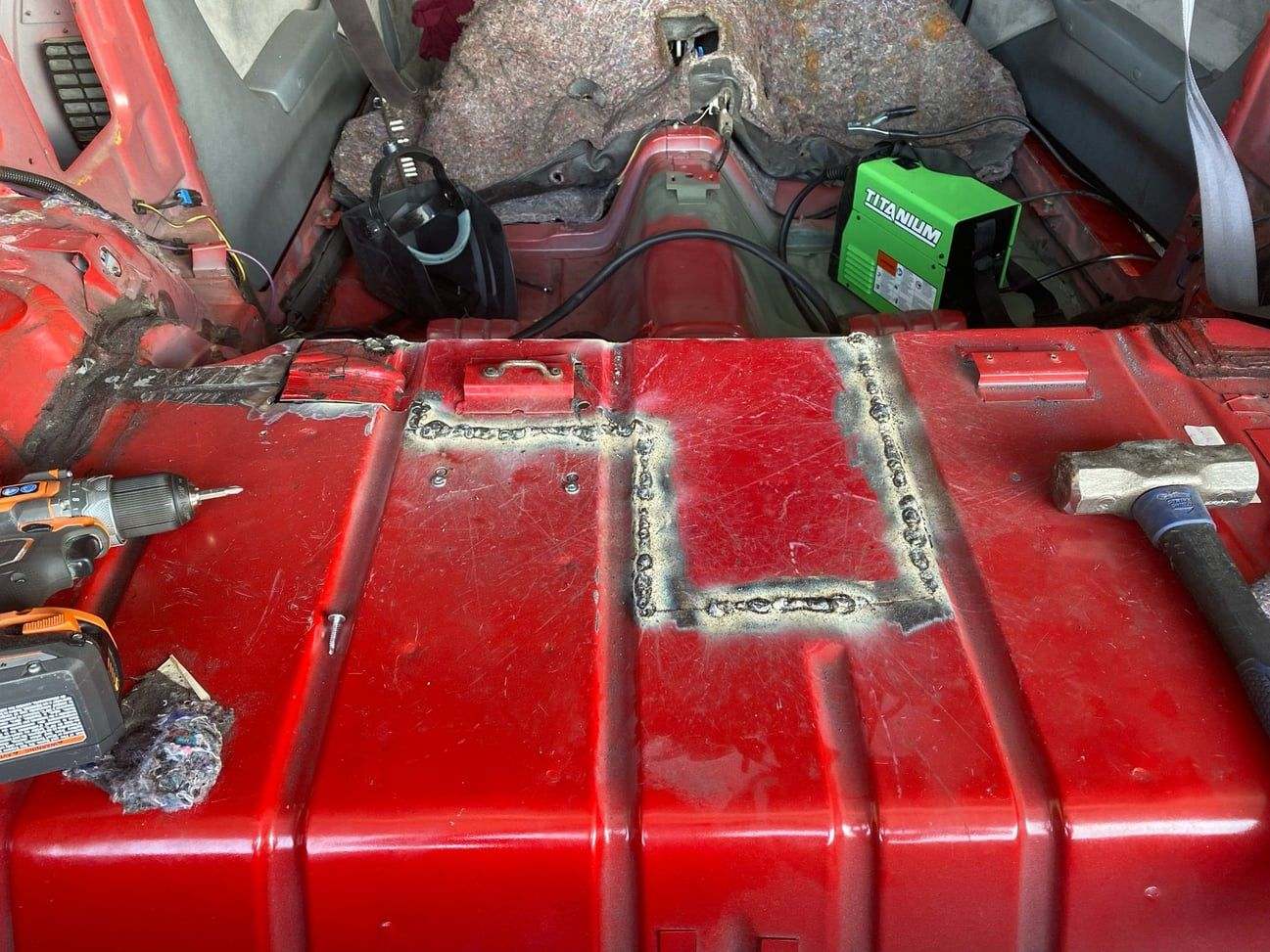

I borrowed some pictures from @Drgnbld from his 89 GTA Refresh thread.
These pictures show the horrible gapping mess of a hole that has to be cut into the hatch area of a 3rd gen to remove and replace the fuel pump with the gas tank still installed in the car.
The first pic with the brown metal covering the hole shows the size of the hole that has to be cut into the body of the car. The next two pics show the horror of it. That is a structural brace cut in two to be able to get the metal lines of the fuel hanger out of and back into the car. These cars are unibody construction, not body on frame construction. The car's body and braces are the frame and strength of the car.
What you see in the pics ahead of the gapping mess of a hole is the back seats and the cabin compartment where you and your friends will be at.
When you get hit in the rear end by some idiot texting while driving the car will crush due to being weakened even more than these car are to begin with and the gas tank will rupture spraying the gas in your tank inside the cabin compartment where you and your friends are at.
The end result could be a Jenn and Friends BBQ.

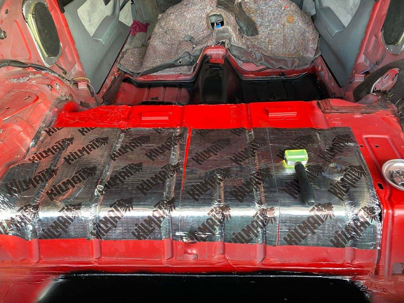

Absolutely do not cut a hole to access the fuel pump!!! As you can see in the pics of my car that were copied and posted by AIRWOLF. I was pissed when I found that level of butchery under the rear carpet. I have since fixed that issue with a new brace and sheet metal from a donor camaro. It still gets my blood boiling when I think about what one of the previous owners did to the car.
