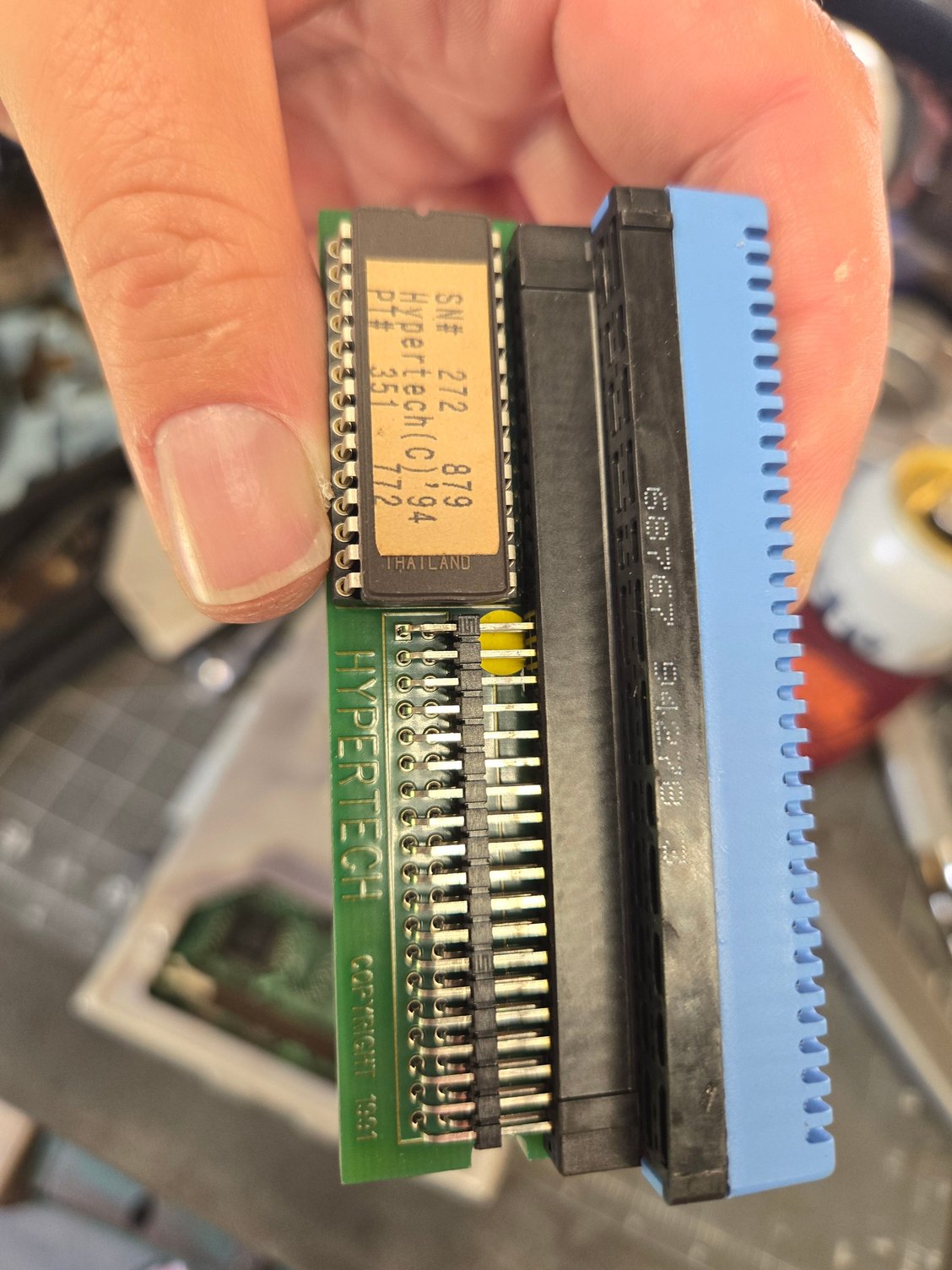

Actually there is nothing wrong with that. That is the same chip adapter setup you would need to tune it anyway. You just saved whatever that adapter cost from Moates. The chip itself is easily removed. The stock Memcal also unplugs and will still have the stock chip in it as well. If you want to read the Hypertech chip and compare it to the stock one you can. The few I found years ago were laughible. Usually they just threw a little more timing and fuel up top. That Hypertech chip is also usually a EEPROM which can be erased and re-written as well giving you an old reliable chip.
After spending a couple hours (was helping daughter with a wood working project as well) looking it all over, that was the conclusion I came to eventually. It was just a knee jerk reaction as I'm new to this and thought the OE chip was long gone and not just stashed on the side of the adapter.
I will say, the Moates G1 adapter I have is nice, but the Hypertech adapter is BEEFY compared to it.
I read the program off it but did it incorrectly so I'll retry that tonight. I'm interested to see what the difference between it and the OE tune really is. I need to order the HDR1 from Moates so I can get the factory BIN off it as well.
