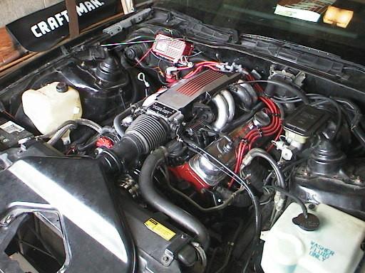

I was told that the header wrap was actualy supposed to speed up the exhaust gases through the headers not hold it in them as it seems to be doing.
As promised pictures of the engine, Enjoy.

Another Picture

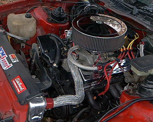

Mark A Shields's Avatar
Posts: 7,164
Car: 99 Formula
Axle/Gears: 342
Header Wrap Pros: Reduced Heat
Cons: traps moisture and speeds up rust
chemicals like oil deposit on them, fire hazard
So take em off. Get the headers coated and will be a lot better.
If plug wires are to close, get wire looms.
mark is that a pic of your car? if so what the hell kind of plug wires are those?
They're Accel 8mm unfortunately, I bought some Spectre Heat Sleeving, that's what the red is, but I only ordered 1 package and it wasn't enough.
