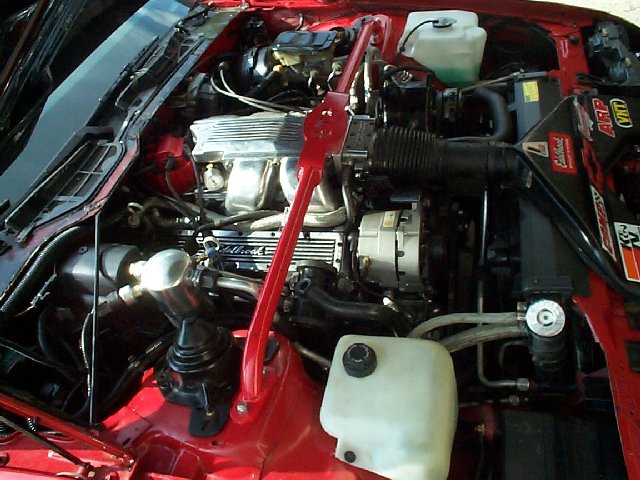

Yep, you need angled. Also get some wire looms, I didn't and burnt 3 separate pairs of wires. I also bought some heat sleeving and MSD wire separators.

The stock Packard Electric 8mm silicone wired with angled boots worked great with Edelbrock headers, and they'll take the heat with no problems. (This, of course, is AFTER the Accel wire failed.)

I know it's difficult to see in the photo, but those are stock Packaard wire:
