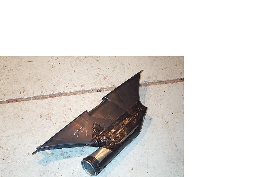

This is the duct after, now it is defrost only

Behind the blower housing I drilled a 3" hole through the fire will. I fed a piece of 3" flexible dryer vent through the hole then over to the end of the defroster peice that I made. I tested it out last night and it works great. Definatly one of those mods you want to be absolutely sure you want before you even start cause there is no way its going back to the way it was.

It's something I've been looking into for a while, but haven't been brave enough to tear into it yet, got a couple ??"s
The piece in the last picture, the defrost duct, thats the original piece right? If so, did you cut it, or was it bolted to rest of the ducts.

Thanks, you should see it now that its got a coat of paint on it, looks like it came that way from the factory.
The defrost duct has once piece that is screwed to it for the front center dash duct. once you take that off you can see that the heat sections of the part are all on one side and he defrost are on the back side. I used a hacksaw blade and cut off all of the heat part leaving me with just the defroster vents. The metal duct peice on the bottom of that started out as a 6" round to 2" x 14" floor box I couldnt find one that was 3" round so I cut that one down to size. The duct tape is mainly to seal up all the seams, everything is screwed together with sheetmetal screws underneith it.
