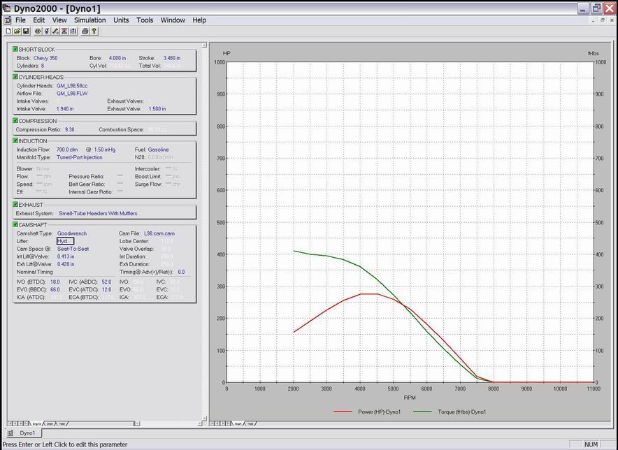

Old Jun 27, 2002 | 11:21 PM
Sitting Bull's Avatar
Joined: Jun 2001
Posts: 3,238
Car: 1986 Sport Coupé
Engine: 305-4v
Here is a DD2000 workup of your engine.
I used the Comp XR252 cam file but plugged in the Crane 2032 specs. They are very similar and ought to give you some idea of where you will end up. It looks like a very strong combo
Keep in mind that DD2000 assumes no polution gear, so you would probably be somewhat less in hp by maybe 5 to 10%.

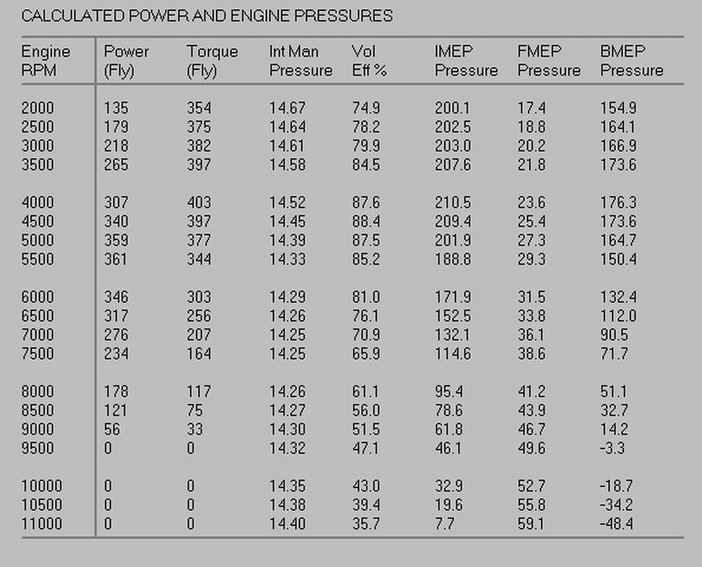

Old Jun 27, 2002 | 11:28 PM
Joined: Jun 2001
Posts: 3,238
Engine: 305-4v
Here are your hp and torque tables.
Old Jul 3, 2002 | 02:39 PM
1990GTA's Avatar
Joined: Nov 2001
Posts: 692
From: Orlando,Fl. USA
Car: 1990 GTA
Engine: 5.7 T.P.I.
Axle/Gears: 3:23
SittingBull,
Thanks for the DD2000 workup. Since you have become the DD2000 man, I was wondering if you could do a workup with the stock cam specs, here they are:
Duration-Intake 202
Exhaust 207
Gross lift .413/.428
Lobe Sep 114.5
I just wanted to see the difference between the stock cam and the Crane. I noticed for compression you had 9.00, the actual compression is 9.3:1. I dont know if that will make a difference, but I just happened to notice that.
Old Jul 3, 2002 | 05:48 PM
Joined: Jun 2001
Posts: 3,238
Engine: 305-4v
Originally posted by 1990GTA
SittingBull,
Duration-Intake 202
Exhaust 207
Lobe Sep 114.5
I just plugged in the lift to the Peanut cam file I have. It's the best I can do because I don't have an L98 cam file. Still, this will be fairly close.
