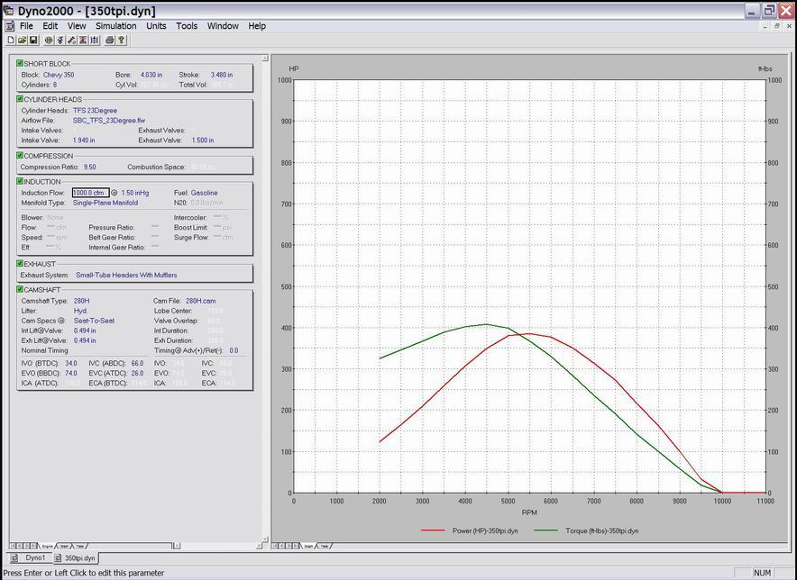

Would someone run Dyno2000 on this?
Posts: 398
From: Long Island, NY
Car: '89 RS Convertible
Engine: 355
I'd appreciate it if someone who has Dyno2000 could run my engine and let me know what kind of power I'm making. The mods are in my sig. The cam duration is at .050 lift (gross duration 288 and 284) and the lobe centers are 110 degrees. The heads are stock 350 castings..I'm not sure of the combustion chamber volume, but it's about 9.4 compression with the .030 over flat top pistons (4 valve relief)..I'm guessing the heads are 64CC? Stock 350 TBI on an Edelbrock dual plane, with Edelbrock shortie headers...1 5/8 primaries, thru a hi-flow cat and 2 1/2 inch single exhaust...an Ed Wright chip and low-temp thermostat...open element air cleaner and cowl induction. Thanks...I appreciate this!!

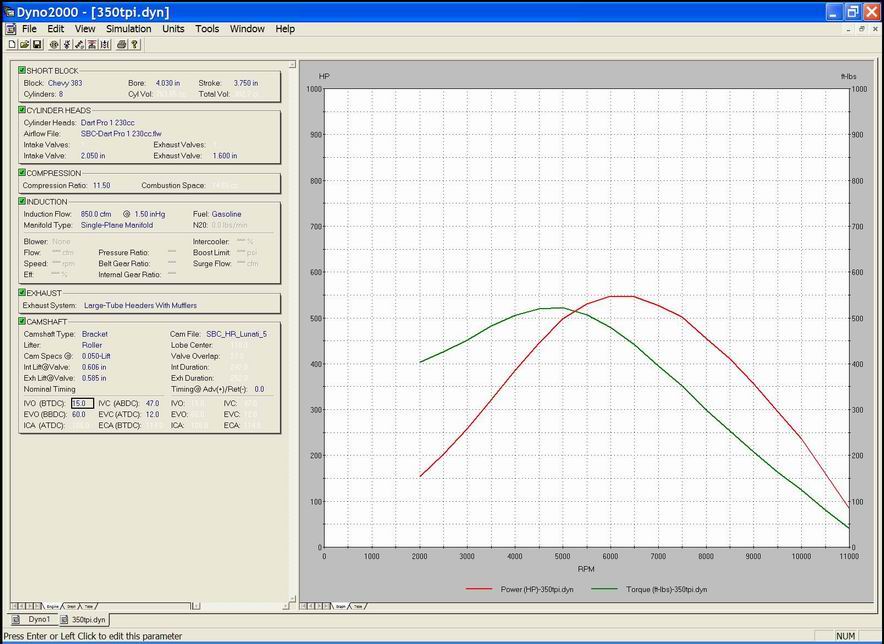

Please Dyno for me
350 block bored .030, zero deck block, 383 stroker with a Eagle 4130 forged steel 400 crank, JE forged pistons 11.5:1 CR,
Lunati Hydraulic flat tappit Camshaft

One more time for the original post. The airflow data is wrong for his heads. This is a little more accurate:

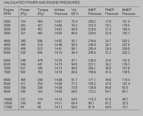

Firstly, using the cam timing specs that you supplied, your cam actually has a duration of 250/252 @ .050".
Secondly, the only flow numbers for Dart Pro 1's that I could find were for the 230cc intake port version w\ 2.08"/1.6" valves - that's what I used (so the numbers may be a little on the high side).
The results:
RPM/TQ/HP
2500/435/207
3000/463/264
3500/476/317
4000/479/365
4500/496/425
5000/506/481
5500/498/521
6000/478/546
6500/448/554
7000/400/533
If you can give me flow numbers for your heads, I can make the adjustment and post the corrected numbers (I saved your engine file).
[Edit]
Your intake manifold isn't port-matched (to your heads) by chance is it? The ports on an "out of the box" Victor Jr intake are considerably smaller than the ports on the 230cc heads. With port-matching, that raises your peak HP to 582, while dropping your peak TQ to 496 (a worthwhile exchange).

I put in what the program will accept. I used the largest Lunati cam file I had and then plugged in your lift numbers. After checking the Lunati website I see that the cam is actually a roller, so I have changed that too. These curves are, as previously mentioned, at the flywheel with no accessories. To compensate, subtract 30 hp for parasitic accessories drag and then 15 to 20% of what remains in order to allow for drivetrain loss. It should come in at somewhere around 420 to 450 hp at the wheels.
You have a MONSTER smallblock here :hail: :rockon:
PS Didn't it work for you?

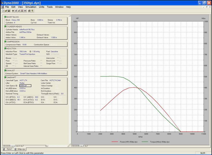

I already built my motor up for my corvette (stock L98 bit the dust so to speak) but i never ran a desktop dyno on it. I decided on all these parts after searching around these boards and talking to people and the machine shop. If someone could run a desktop dyno on it that would rock just for *hits and gigles. Here it is
377 (new 350 block w/383 crank)
10.6:1 compression
AFR 195 heads
Superram
LT4 Hot cam and matching LT4 roller rockers
1 5/8" headers
new exhaust
Thanks

Who did you get this from?

And here are the tables. This ought to be 300 rear wheel hp. And look at that torque!!! If this is a road racer and you choose a rear end ratio that keeps you in the torque sweet spot, that car will be VERY hard to keep up with coming out of the corners

As i said, i searched these boards and talked to people and i stopped being a tight-@$$ money-wise
. My old L98 in my vette ate a few valves when this lube-jock took it for a joy ride when i dropped the car off to be smogged
, but i ended up getting a little $$$ to work with and i just ordered all the parts. I have another TPI base sitting in my garage from an '88 IROC (i bought the 23 degree heads) that i'm going to use. I'm definately going to be "removing material" from the base and the superram itself so i can tap into that 450-500 lbs of torque for a little more top end. I noticed on the screen you showed that that dyno sheet is with AFR 190s, the heads i have are 195's with 2.02/1.60 valves. I don't know how much of difference that'll make....

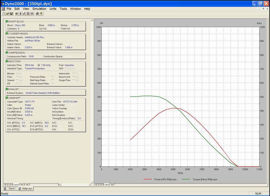

Yeah, I don't have the 195 flow file but I plugged in the larger valve sizes for you here. It helps in both hp and torque

can sombody run mine through my engin specs are in my sig, and I have flattop pistons w/2 valve relefs each(dont rember the cc but they are small
Joined: Jun 2001
Posts: 3,238
Car: 1986 Sport Coupé
Engine: 305-4v
And the hp and torque tables. I think you don't need anywhere near that size of FI for the size of this engine.

I was looking at the #'s on the graph sidebar and I have 2.02/1.60 intake/exaust valves (came with heads) not 1.94/1.50 valves, I'm not sure if that would make a diffrence, but my car pulls allot harder then 385hp, I can smoke the tires in all 5 gears., Thanks for running it through, I was thinking about getting dyno 2000 but I'm saving for my back home.
Joined: Jun 2001
Posts: 3,238
Engine: 305-4v
You know, that is a lot and the parts you use are not really radical, at least compared to some of the other workups we've done here.
Sitting Bull's Dyno on my 383
I think you used the wrong cam specs on my combo. I talked to someone who gave me the program and tried it myself. You used the right lift but BTC is 18, ABC 52, BBC 60, ATC 12 this is my chart now. I hope this is accurate, this engine will move! Does any one know how accurate this is?? Also how much HP will I lose through the drivetrain with a 700r4 tranny and stock flywheel?
HP TQ
4500 441 515
5000 501 526
5500 541 516
6000 568 497
6500 579 468
7000 571 429
7500 556 389
HP TQ
4500 441 515
5000 501 526
5500 541 516
6000 568 497
6500 579 468
7000 571 429
7500 556 389
Joined: Jun 2001
Posts: 3,238
Engine: 305-4v
Re: Sitting Bull's Dyno on my 383
HP TQ
4500 441 515
5000 501 526
5500 541 516
6000 568 497
6500 579 468
7000 571 429
7500 556 389
HP TQ
4500 441 515
5000 501 526
5500 541 516
6000 568 497
6500 579 468
7000 571 429
7500 556 389
Thus 579-30=549 hp
549-20%(110)=439 hp
You should have right on to 440 hp at the rear wheels. That is a dynomite small block :hail: :hail: :hail:
