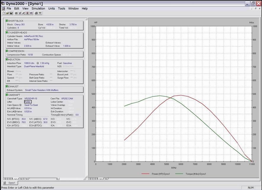

Could someone run this 383 through DD2000?
383ci
AFR 195 heads
Comp cams xte 282
SLP 1 3/4 headers
10.5:1 comp.
1000cfm BBK TB
Ported plenum
SLP runners
Edelbrock base ported
Is there anything else you need to know?
I'm hoping for about 470 hp and 500 ft/lbs.
edit 1.6RR's
Old Jul 11, 2002 | 07:32 PM
Sitting Bull's Avatar
Joined: Jun 2001
Posts: 3,238
Car: 1986 Sport Coupé
Engine: 305-4v
Here you go. I don't have the AFR 195 head file so I used the AFR 190 file, which I assume is pretty close.

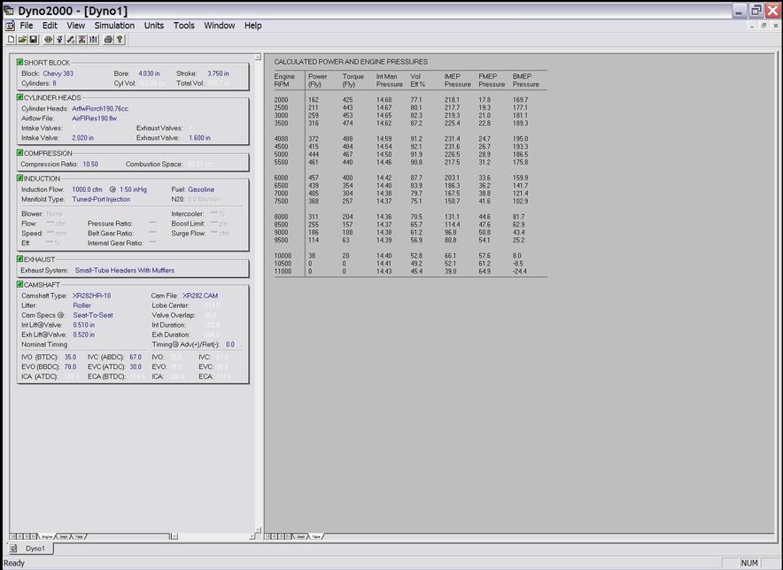

And here is the data tables. It looks like you are able to achieve your goals

Those numbers are incorrect. You need to change the manifold type from "dual plane" to "Tuned Port". Then look at the numbers drop.....
Sorry.
Old Jul 11, 2002 | 08:03 PM
Joined: Jun 2001
Posts: 3,238
Engine: 305-4v
OK, I just saw the TB for induction and thought straight throttle body. Anyway, it dropped about 30 in the hp and virtually not at all in the torque, so it will still be pretty close to what is desired.

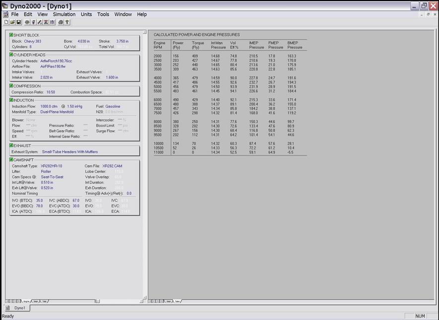

And here are the tables.

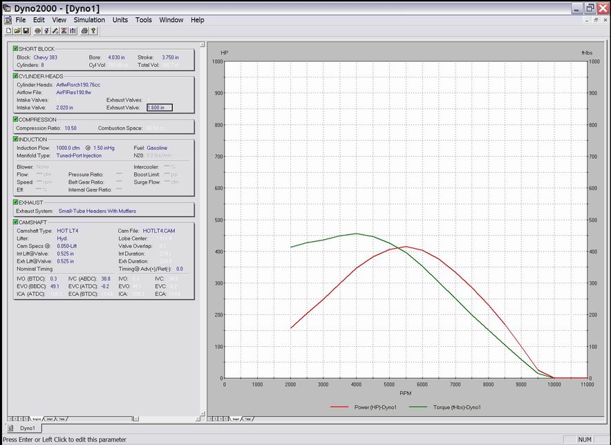

Could you run it with a LT4 hotcam and 1 3/4 headers?
Old Jul 12, 2002 | 01:27 AM
Joined: Jun 2001
Posts: 3,238
Engine: 305-4v
OK, here it is with the Hot Cam. I don't know whether your AFR195 heads have 2.02 intake valves or not, so I told the program it did. If not just subtract about 10 hp.
The program doesn't allow for inputting header sizes directly. It just goes from "Small tube headers" to "Large tube headers." 1 3/4" headers would still fall into the small category and at this hp level there is only a 5 or 6 hp difference between the two.
Attached Thumbnails Could someone run this 383 through DD2000?-resize-screen.jpg
Old Jul 12, 2002 | 01:28 AM
Joined: Jun 2001
Posts: 3,238
Engine: 305-4v
As you can see, the Hot Cam isn't the ticket for this engine. I think it has less duration than the Comp and that's why it produces less power. However, it might be more manageable as a street car.
