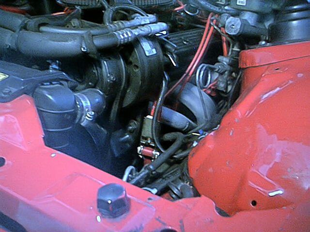

mystikkal. You said you keep breaking the rubber mounts. Try using a tiedown strap on your motor. A lot of Grand Nationals have them. Straping the engine to the fram on one side reduces how much the engine pivits on the mounts under stressful situations. I used to break mounts in my TA all the time. Then i used the strap and haven't broken them again since. Even on drag radials I had no problems.
