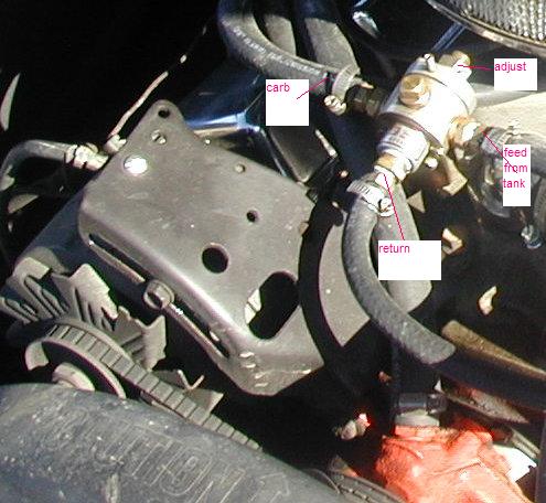

Malory 3 port is what I used in my swap. I have had no problems with it....and the 3 port has 4 ports counting the return..
Attached Thumbnails lots of problems with tpi -> carp conversion-upper-bracket-afpr.jpg

Heres a picture of my mallory regulator connected to the stock rubber lines. Braided line on the left is the supply line, braided line on the right is to the carb and the one on the bottom is the return.
Attached Thumbnails lots of problems with tpi -> carp conversion-shortblock2.jpg
