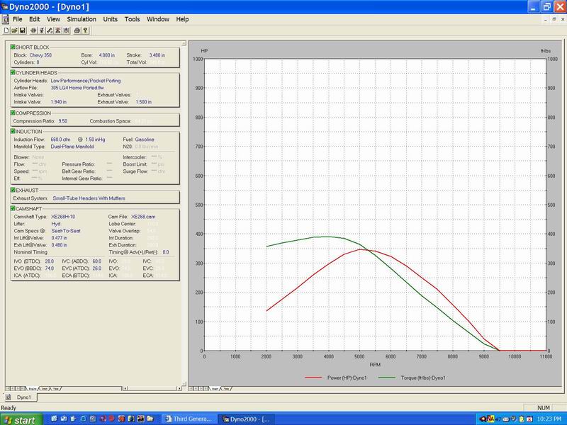

WEll, in DD2000, I know not that accurate, but with 2.02/1.6s and 10:1 compression I'll be pushing 384hp, that's like 84 more than I have now.
84 hp from a set of heads on a 300 hp engine is just NOT going to happen. Heads and a cam? Maybe.
These 84 hp heads would also have to have VERY tiny combustion chambers to get your 8.5:1 ratio up to 10:1.
Vortec heads use 1.94 valves and they'll support 450 hp. So will the 305 heads because they flow the same as the Vortecs when he's done with them.

I dont' see why a great set of heads couldn't get me 384hp if I wanted.
Since I have a nice healthy cam, slap on some heads there we go. Or am I missing something. Cause it's not hard to build 350+ HP with a 350 with my cam/intake combo.
An excellent flowing set of heads will add 10 to 15% more hp to an engine. That is the only guidelines I've ever seen regarding this topic for a street engine turning 5500 rpm. So let's do the math. 300 hp x 15% = 45 or 50 hp tops.
That's just the nature of the beast and I think we are being generous here.

Hmm, ok.. Just wondering, do you think 300hp sounds like a fair estimate for my combo now as it is?

With what you have in your engine now, and adding a good set of heads like F-Bird's, you'll be at 350 hp at least. Maybe even 360 to 370 hp.
That is an excellent little 350 and will wipe the smirk off a lot of Mustangs and Vettes

Here is what DD2000 shows me and I think this will be very close to the truth of the matter with your engine.
That's with the 305 heads huh. Not bad at all.
Yes, I created a custom flow file for the LG4 heads, using the flow data that F-Bird'88 supplied me. Normally DD2000 will be around 20 to 25 hp too high, due to its overly enthusiastic dual plane intake manifold power estimates, but for a Stealth or Performer RPM it is pretty close.
Thus your 350 hp engine will have a net power rating of about 325 hp or so when you subtract the parasitic loss the water pump, alternator, etc. Subtract another 20% for loss through the drivetrain and you have about 260 rear wheel hp. That should put you comfortably into the 13s.
