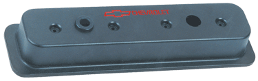

i ordered a set of valve cover from gm..... there badass and offer about a 1/4 inch taller clearence thn stock centerbolts.....

valve covers
i got mine from gm where i live because i didn't have the cash right now......
you can get them from scoggin dickey or gm perfromance parts online........
there like 120 or somthing.... they come in black as shown, polished or crome.......
