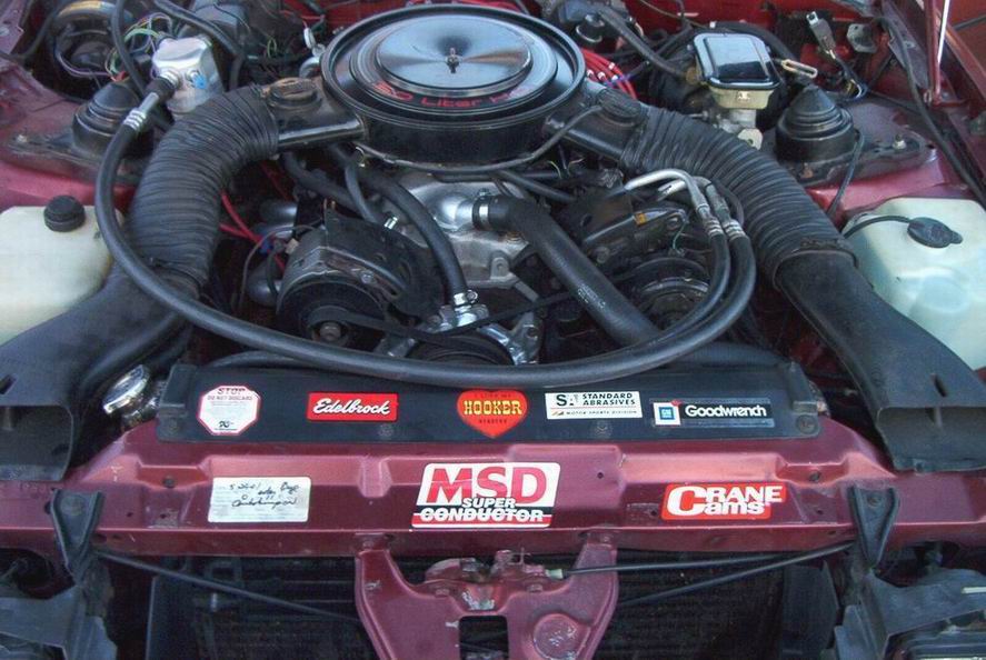

They keep my little 305 VERY happy, indeed
And F-Bird'88 tells me he has folks running them on 400 ci smallblocks with NO complaints
