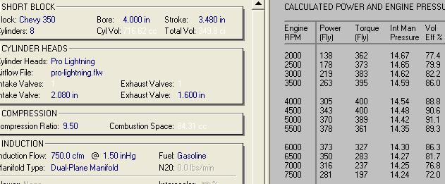

28" of water, thanks, let me redo that, I'll post a scrn shot of the heads with my combo in a few mins, I was impressed.

Dang, I changed the stock setting of 1" of pressure drop in H20 to 28" and it killed my #s.

Here's the table with the Pro Lightnings at 28" of H20.

What cam , intake etc are you using?
I just ran a 350, 9:1 compression ratio, 750cfm carb, dual plane intake, mild Comp Cams XE268 cam and got
372 HP @ 5500 RPM
394 ft/lbs @ 4500 RPM
Here's the screenshot

Hold on, I'm about to have a heart attack, my bro says my cam box says 268H when I ordered teh 268XE, and the cam card said I had the XE one.
I will be using a 650DP, I have a Weiand Stealth intake too.
I'll be getting a 2800 or so stall by Xmas.
I was only complaining, because earlier when I entered it at 1" water, it showed over 400hp, that's all.
