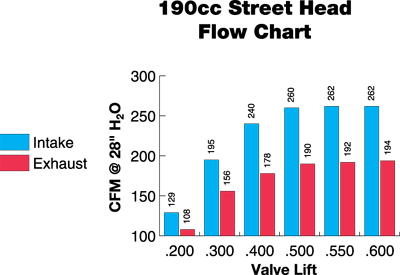

Because that is alot of flow from a 305 Head.
AFR 190's for example. Only 20 CFM better.
I see those are F-birds "Magical" 305 heads, Interesting.
https://www.thirdgen.org/techbb2/att...&postid=630921
