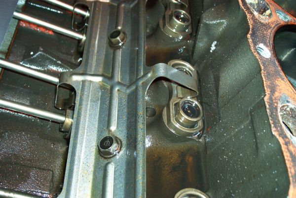

this is a pic of my roller block, you can see the metal "spider" in the lifter valley holding the figure 8 shaped hold downs around ever two lifters. my engine uses a hydraulic roller cam which is hydraulic lifters (as opposed to solid) and roller tips (as opposed to flat tappett). so you can have four different setups, hydraulic roller, hydraulic flat tappet, solid roller, solid flat tappett. the advantage to hydraulic is that you dont have to readjust your valve lash all the time but it cannot handle really high rpm's like a solid lifter. for a street car i'd stick to hydraulic. a roller cam will reduce friction significantly, resulting in i'd say 10-20hp over an identical flat tappet cam. you cannot use a roller cam in a flat tappet engine because roller cams often have steeper lobes which will get gouged by a flat tappet lifter

one more
Attached Thumbnails It's scary how dumb I am, cam questions Hyd. Solid, roller?-pastedimage.jpg

Great pics. Thanks.
So it is basically money in parts, not anything extensive though like machine work then?
