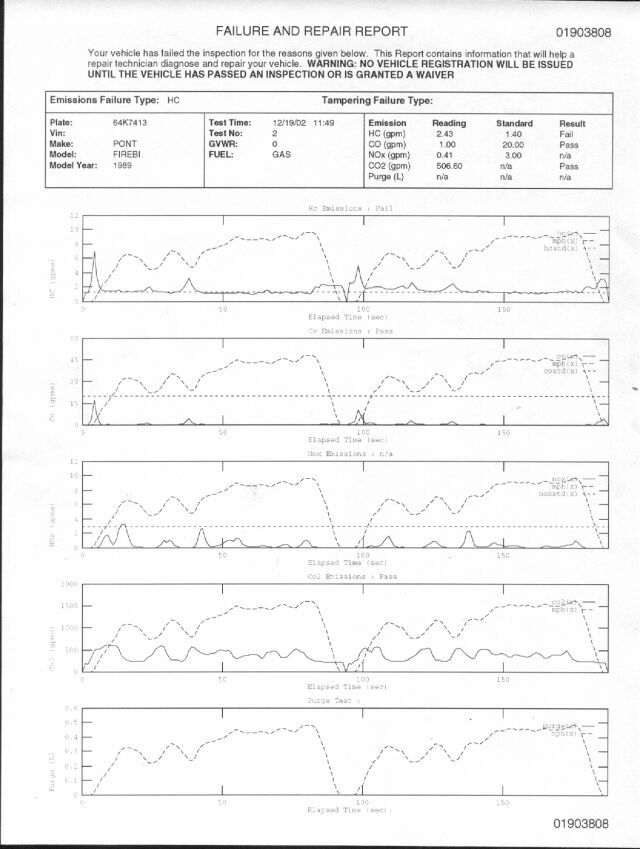

I just took the car to emissions with the new motor. Vital specs are a hotcam, no emissions equipment besides a new catco cat, and DIY PROM capibilities. I attached the graph so you have a visual on whats going on. Both HC and CO are high at idle and they also both shoot up upon decel. HC are JUST over the limit during crusie and accel while CO is very low. Is there anything I can change in the PROM to lower particularly the idle and decel emissions? I am running ARAP bin with a 129 idle BLM and cruise BLM from 124-130, which is decent for a MAF car. My temp will not go over 185 either because of the 180stat and the fact that my fan runs all the time, no matter if I set the A/C switch thing to N/O or N/C, but even if it was around 210, I don't think it will be enough. What do you guys think?

Does anyone have insight on why my reading are so high at idle? Also, both HC and CO spike upon decel, which is normally caused by a rich condition, but how is that the case with DFCO? I read that TRAXION passed with flying colors by forcing the car into open loop and running it lean. I am going to try that first but by a different method, Im going to try to enable highway mode at 10mph or so and try running the stock timing tables instead of ARAP.

HC and CO on decel is one thing we spent a long time tuning on a chassis dyno in order to get a 1980 MGB to pass the People's Republic of California old FTP 75 full test. One thing we learned is that Decel Fuel Cutoff is hard to do cleanly, mainly because the manifold gets wet with fuel, and when you shut off fuel, and close the throttle, all the fuel on the walls gets passed through the cylinders unburned because it isn't enough to support a rich enough air fuel ratio to burn normally. It also presents a problem when the fuel is turned back on. We ended up not using decel cutoff, and had better results, but the trick that really cleaned it all up was a "gulp valve." It basically allowed the air pump air to enter the intake manifold (albeit restricted), during low MAP conditions, and without decel cutoff, the MAP didn't drop quite as quickly or far. You might be able to enable more IAC opening upon Decel. I don't know where or what it's called by GM, but basically I think there is some function where the IAC is opened X steps above Y RPM, or maybe the Throttle follower multiplier can be increased.
As for Idle, CO is mainly associated with rich conditions. HC is from rich or missfire, which may be more common than you'd think at idle and with rumpity cam (internal EGR dillution). Are you running closed loop at idle? Air injection works miracles at cleaning up Open Loop Rich operation, such as warm up, or sometimes idle, depending on who's tuning it. Catalytic converters (3-ways) need a strict 14.7:1 Air Fuel ratio to be most efficient. It also must be HOT (enough), and to maintain a hot cat at idle can be hard, and same goes for keeping an unheated O2 sensor hot. I'd put in a heated one, especially since they are about as cheap, and easy, no super easy to install, just wire one of the whites to a switched +12 (fuel pump relay?) and ground the other. That'll enable sooner (if the O2 is not responding while other sensors are OK for CL), more accurate closed loop.
CO being LOW during cruise, while HC is High suggests an occasional misfire, or Lean misfire, but closed loop should eliminate Lean misfire (unless there's an out of spec injector). So, perhaps you have a small ignition misfire. Check your plugs. If you don't know what to look for, do a search or something, but mainly look to see if one plug is wet, black, white, or anything other than brown. Brown (tan) is good. That'll indicate a more frequent problem, i.e. injector, or really bad spark plug wire.
