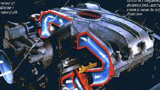

This is not my engine exactly, this is the v8 version, but that is what my intake looks like. As far as I know, mine has always been TPI...

this is whats on top of mine...I just found this picture somewhere, just to give a basic idea since I'm lazy and can't find a camera around here lol

Okay, I see now...you have a V6, not V8.
Replacing the MAF straight forward, only tricky part is unclamping it (assuming it's original) from the aircleaner duct.
