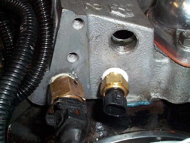

Posts: 1,823
From: San Antonio, TX
Car: 1988 IROC-Z
Engine: L98 (350 TPI)
Transmission: MD8 (700 R4) + 3.42 LS1 Rear
replace the CTS sensor. (Picture Courtesy Of Vader)
it's the one on the right. the smaller one.
the one on the left is for the cold start injector.
