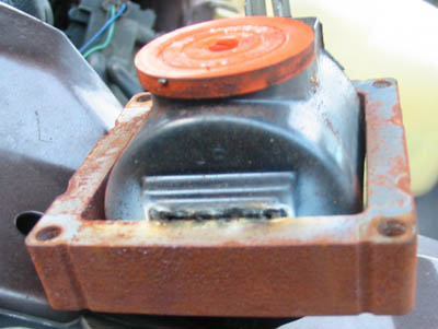

My car has a misfire, and I am not sure why. I replaced the spark plugs, wires, cap, and rotor, and its still misfiring. I didnt replace the coil, because I dont know if its bad or not. Here are a couple pics of it, what do you guys think? It almost looks burned on one side.

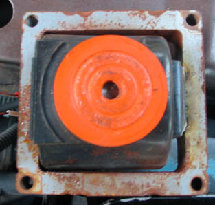

Another, showing the spot where it looks burned.

That coil should probably be replaced, misfire or no.

Yeah, that one looks like it's toast..... looks alot like what happens when plugs are gapped too wide.

Looks like its time to upgrade to a MSD coil or Accell......that one has seen way better days .......I have a 1992 Firebird and run an Accell in mine......never had any problems with it.......but you might want to look at you ICM (ignition control module)also...just my $.02....good luck tracking down that misfire......

I would suggest getting a new Accel coil.

check to see if all cylinders are firing.. definitely replace that coil and re-gap your plugs
