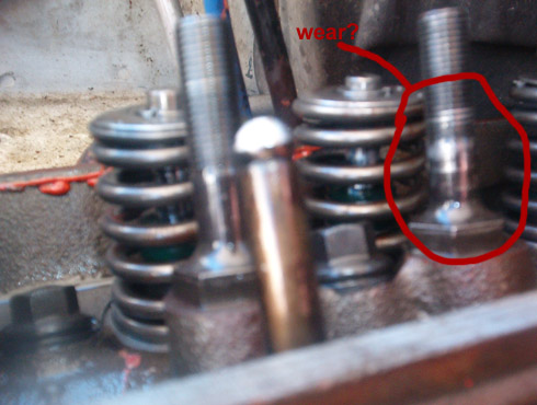

I finally got around to pulling the intake manifold and I'm at a complete loss here. There is nothing wrong with the lifters and from sticking my finger in the lifter bores the cam feels smooth and there are no metal shaving or particles anywhere.
The only thing I did notice was that the rocker stud looks like it has some wear on it compared to the others... I'm thinking this is a result of my current problem and not the cause? Everything looks normal to me I'm completely confused now...
Note the rocker stud has no gashes or anything. It just that the black finish has been rubbed off. None of the others are like this.

Old Feb 8, 2003 | 12:54 PM
Pony Killer's Avatar
Posts: 726
From: Atco, NJ, USA
Car: 1986 Z28
Engine: 355
Transmission: th400
check the rocker that came off of that. looks like it wasn't gettina any oil and started to burn the stud up.
are they roller fulcrum rockers are do they have the pivot, ball? either way it looks like that rocker stopped getting oil. you have to find out why, check the pushrod, to see if the oilpassage is clear. start there,and work down.
Old Feb 8, 2003 | 01:36 PM
88IROC350TPI's Avatar
Joined: May 2001
Posts: 2,009
From: Pitman, NJ
Car: '89 IROC-Z
Engine: Canfield 195 headed 358ci
Transmission: TH350, Art Carr 9.5"
Axle/Gears: 3.92 Dana 44
The rockers are the stock ones. They look fine no marks on them or anything. The oil passages in the pushrod and everywhere else are also fine.
Old Feb 9, 2003 | 05:34 AM
radiateu2's Avatar
Posts: 751
From: Walla Walla Washington
Is the pushrod bent? Does the lifter look different than the others? Maybe you should check the lift on that lobe? and how does the pivot points on the rocker look?
