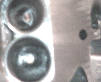

Iroc: I more than agree with ya that the vortec are the best *New* head out there for the $Bucks$.
I have 2 sets. I also have ported quite a few of the 305 heads with bigger 1.94 x1.60 valves and they do indeed out flow
the stock vortecs. This is flowbench verified.
Have been working on a special combination radius angle cutter tooling that really puts a cool radius in the bowl area.
Going to try this on the 305 heads and the vortecs.
Should result in a higher volocity and flow at low and mid lifts.
reduces the porting time and decreases the port to port variance.
I'll post the results.
