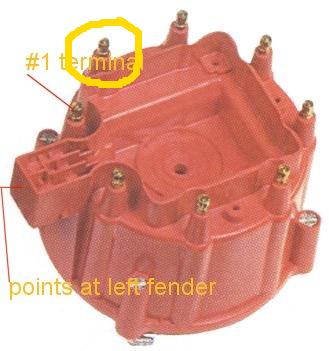

Originally posted by Morley
The way I described is how I set my dist up. Then I use the first terminal forward of the lug for the wires as #1 and count around the cap from there.
Ben
Assuming you mean drivers side by left I circled the one that I currently have the #1 spark plug wire on. Yours is one different. Do you know if I have the motor at top dead on the compression stroke, what agle the rotor should be pointing in degrees?
Thanks
Ben
Thanks
Ben
Thanks
Ben
Thanks
Ben
So long as you are sure your rotor is pointing exactly at that terminal when the #1 is at TDC you should be ok, that and if all the wires are on the proper terminals.
