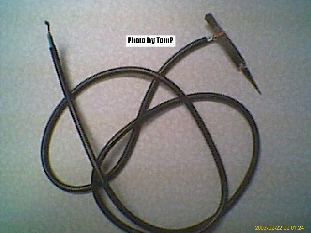

Thanks for the help, guys! I have a B&M Megashifter, which doesn't use the gear shift lock cable- I can turn my car off and take the keys out in any gear.
I wound up doing what I said I would in my first message; I wound up cutting up an old computer power cord, and using it to spin the starter directly. Bummer that there's no way to get to the ignition switch under the column directly. I'll have to look into the park/neutral switch for starting the car.
Never thought about the screwdriver idea; I wish I did; it would've saved me from whipping up a cable! The "clip" at the end is a set of "squeeze to open" tweezers from a computer tool set. I twisted all three wires in the computer power cable to make "one", looped one end around the tweezers, used the tweezers to clip onto the solenoid terminal, and touched the other end (above the car) to the alternator output terminal.
Then I hauled butt down to the dealer, and picked up the key lock. Got home, and swapped them out. It was fun getting a brand new key; almost like getting a new car! While I was in there, I also replaced the cancel cam and the cancel springs- my left blinker wasn't cancelling. Turns out it was just the left spring that was broken, but I replaced the cam anyway (and both springs, too).
What kind of grease did they use inside the column? I noticed there was grease on the cancel cam for the horn contact; but I didn't have any grease that was light-brown colored, so I just smeared some dielectric on the horn. Maybe the new cancel cam will fix my "intermittant horn when turning" problem.
Here's some pictures; eventually, I'll whip up a webpage about it.
First, the "Macguyver-style attack"-
