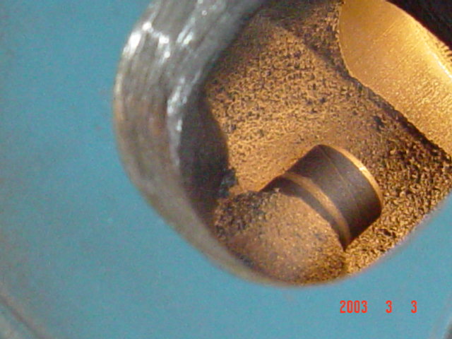

After first 20 minutes with die grinder...

How's that for casting flash? Look right in the center of the photo - a big chunck sitting on the rocker stud nub that sticks down into two intake ports of each head.
The other head doesn't have nearly as much flash in the port/bowl areas.

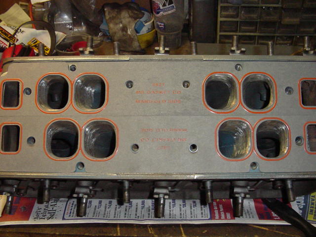

Two hours total of grinding so far, all the intake ports gasket matched and blended as far as I can reach with the stone.
Now to clean up the exhaust a little, radius the edges in the chambers and bowls. Then I'll be ready to take the rolls to the ports.

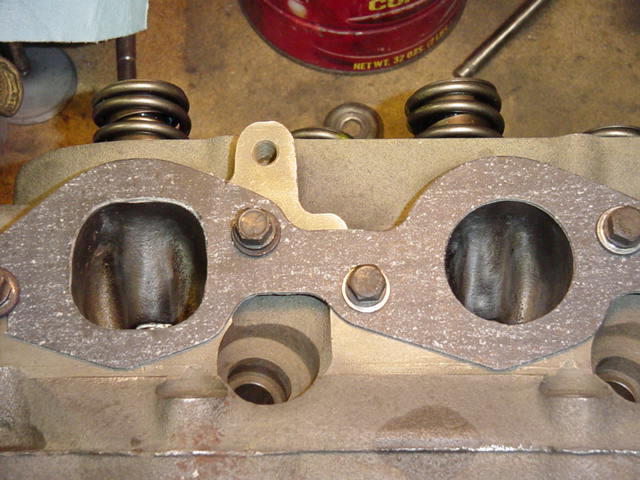

Think these little guys will in the exhaust bowl will affect flow much?
Me neither.

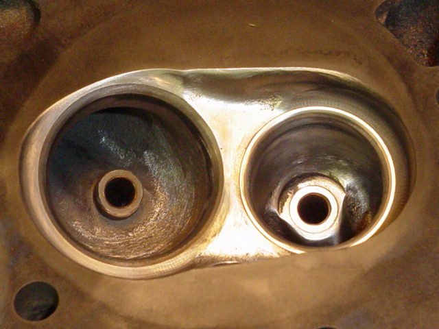

Just about finished...
I had a chance to put several hours together on them today, so I went to work rather than take in-process pictures.
Here's a chamber. I didn't spend a lot of time finishing them - they just weren't that bad, mostly rounded sharp edges and polished off what little casting surface was actually still there (the factory machined about 75% of the chamber surface area).

They showed me the fit of my valves in the new guides, when I picked up my heads last summer. I think the machinist said there was about 2/1000ths (.002) of play when the valve was inserted. I jiggled it around and it didn't jiggle much at all.

This isn't the clearance between the stem and the guides, but the co-axial relationship between the valve sealing surface and the stem. In other words, when the valve closed, it had to move sideways in order for the valve sealing surface to meet the seat sealing surface.
I found the cam card tonight. I didn't have it right in the previous post. The specifics are: General Kinetics C2H-270-HT (270 advertised duration); single pattern; .510" lift (1.7:1 rockers - stock); 224 duration @ .050"; 110 degrees lobe center lines exh. to int.; intake lobe centerline 110 ATDC. A bit more than an "RV cam", with a pretty steep ramp rate (higher than typical ratio between .050" duration and advertised duration). For reference, my previous cam had 280 advertised duration on the exhaust, but only 214 @ .050".
I found a set of Hedman hedder gaskets at a local speed shop (apparently a customer didn't like the small round openings). Here's a pic showing one opened up to match the port (on the left), and as-received (on the right). Gives you an idea of the work I have ahead of me to match the hedder flanges.

I guess I'm not explaining things properly. He was talking about the way the valves were ground previously - the valve face sealing surface was non-concentric to the stem by a couple of thousandths on some of the valves. He cleaned them up so they're back where they should be now. As for the supplier, the newest valves are 6 years old, the 4 oldest are 37 years old.
He did a 3-angle job (didn't even comment about the back-cut suggestion), left a fairly wide sealing surface (he said - compared to all-out racing job. I didn't see them, don't have a dimension). Said that would protect them against today's gasoline quality.
9"? What 9"? I've got an 8.2" 10-bolt. I doubt excessive torque will be my "problem", as I'll probably reduce it slightly. Maybe not, though. Would be sweet if both low- and top-end improved.

hey 5-7..Ive been reading a lot about porting..getting ready to do my new heads. I find it interesting that you are matching your headers to the ports...some of the info I read says Not to match the exaust ports..that that step down is ..well I cant explain it ..here is one quote...
In most cases, you never port match the exhausts. Many stock exhaust manifolds and virtually all tube headers will have larger port sizes than do the heads. You want that "step" from the port to the larger header tube or exhaust manifold because, as pressure pulses flow back and forth in the exhaust system, it acts as a "reversion dam" by resisting back flow of exhaust gases into the port. If you end up with the rare situation where the stock exhaust manifold has ports smaller than those in the head, you will need to port match. Use the same technique used to match the intakes.
This comes from Standard abrasives web site...Im a little confused about this....

My header ports are smaller than the exhaust ports in the heads. Therefore, the flow hits a step down as it reaches the headers. This is the opposite of what the instructions describe (path gets larger as the flow goes out, typically).
I actually intend to open the headers slightly more than the port - 1/8" or so. But, for starters, I've trimmed the header gasket (which is actually slightly larger than the header port as delivered) to the port; I'll open up the header flanges to that plus the 1/8", then trim the gasket to the flanges.
The multiangle seat grinds are not a problem as long as a decent amount of the 46° seat width is there for durability. Then again, I tend to err on the side of caution instead of all-out power. That's just me.
A 10-bolt behind a Mk-IV? O.K. Just don't hit it with too many clutch dumps. You are kidding, right?

This guy tends to err on the side of caution as well. So, I'm sure there's plenty of 46 degree face there.

Port matching the headers has taken me longer than the head porting work, and I'm still not done!
The tranny with the shift kit and about a 50-50 mix of AMSOIL Dexron and Super Shift is amazingly quick on the shifts - almost harsh. I am considering a stiffening cover to help strengthen it a little, but the rear does not appear to be the weak link.
If I was running a rock crusher, no doubt there would be two extra bolts in the cover...
